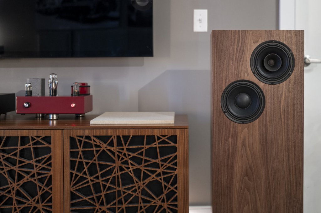

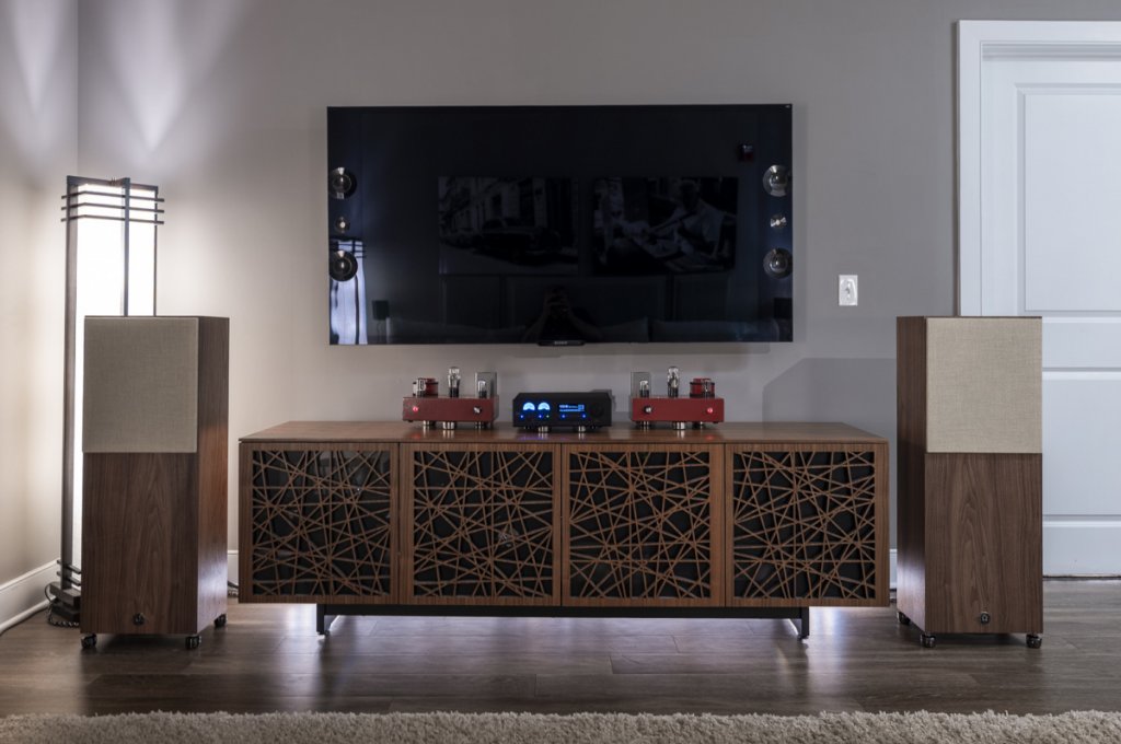

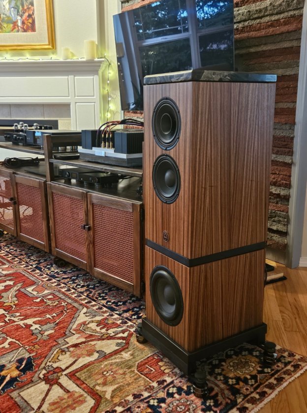

I have been working with our favorite master designer and craftsman for a while now, upgrading my SAMs to SAMHO's.  I also added outriggers with Herbies giant threaded stud gliders as feet.  At long last, the project is complete!  I hope you will enjoy with me.  :thumb:
Some long-time members here will recall my original brainstorming and result integrating standard SAMs with, custom built cabinets by Louis, Rythmik 8" servo woofers with Rythmik plate amp.  I still run a pair of Rythmik F12 subs as well.  Here's the link to my original thread: https://www.audiocircle.com/index.php?topic=134489.0.
I will link relevant sites for the various primary components and then add some photos.  But, first, I have to say that SAM to SAMHO is more than I expected.  I was nervous making the change since the SAMs sounded wonderful and I didn't want to lose that.  But after some breaking in of the new helper drivers (I transferred over the original alnico drivers, Rythmik components, and bases to the new cabinets), they are sounding better and better.  It took a bit for those new drivers to loosen up and offer increasingly articulate bass.  And they produce a surprising amount of bass for their size.  Overall presentation of the sound is bigger, output is greater (running at lower volume settings now), and dynamics are more vivid.  All of this makes for a very "alive" feeling.  Not one of the big endorsers of many esoteric tweaks, I have to admit that the Herbie's gliders really help with transparency and articulation at higher frequencies, too.
Louis was wonderful, as always, with advice and generosity.  His results are amazing, both in sound and aesthetics!  I love how he runs the grain continuous between the monitors and woofer cabs.

Thanks for your kind words!
My new SAMHOs are 11w x 14d x 22h.  The SAMs they replace were 11 x 14 x 20.
The dimensions of the SAMs were the same as his usual production.  The current HOs are 10 x 14 x 24.  He made them to fit the footprint of what I had before so the height is 2" shorter.  We did this since I was reusing the black bases and the stone tops.  I like it that way.  Allows for a slight tilt up and, overall, not too imposing.  Two inches isn't that much, but it would make a difference in those respects.
If one wanted to do the same thing with the 10 x 14 footprint, it would likely fit, but obviously more tightly.
........Pete

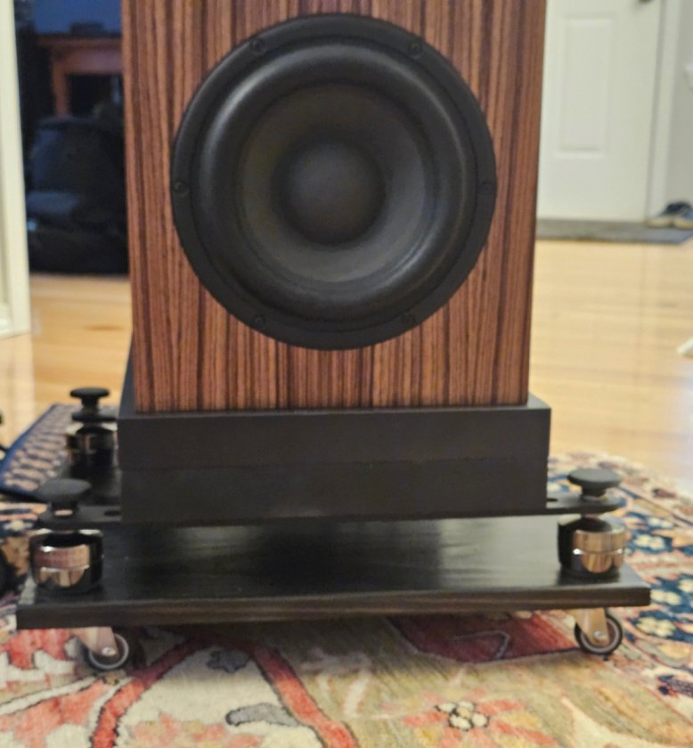

I thought I would update on my speakers after a few years.  Several improvements that have really made a difference and may be helpful info for others.
Isolation:  I replaced the Herbies footers with ISOAcoustics GAIAs.  Much better isolation.  And, I made a "spacer" that goes between the monitors and woofers.  It is a frame and allows me to use four ISOAcoustics OREA Indigos under the monitors without detracting from appearance.  In fact, I think the spacer helps appearance.  It also raises the monitors an inch+ which is beneficial in my seating arrangement.

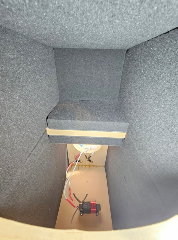

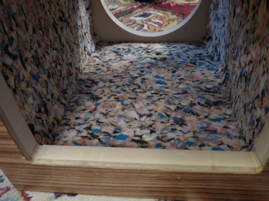

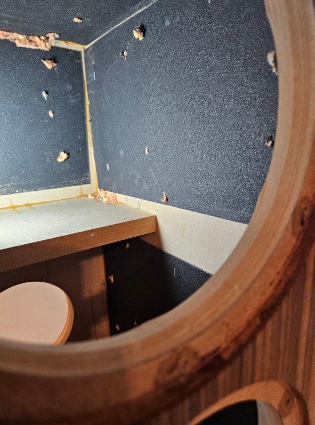

Internal Damping: I removed the original, thin damping mat material and carpet foam and replaced with "NoRez" from GR Research (https://gr-research.com/product/norez-two/).  This has made a huge difference.  Everything sounds cleaner.  It feels like the speakers have just settled in to be more comfortable with themselves (if you can make sense of that statement!).  I recommend considering this tweak.
Platform: This speaker system has gotten quite heavy. 95lbs each.  That's before the NoRez which is fairly heavy itself and brings them close to 100lbs.  With the GAIAs as footers, they won't slide at all so moving them is quite difficult.  I actually had to remove the monitors from the stack, move the bottom section, and reassemble.  So, I made a simple platform with casters.  Since the speakers are on the GAIAs which rest on the platform, I don't think it detracts from the isolation at all.  Moving them is now a breeze!  Also, raised another inch+ bringing the alignment with ears at the listening position just right.
Here's some photos...  before and after with the damping installation and the new footers and platform.  And here is a link to the thread at GR Research tackling the project:  https://www.audiocircle.com/index.php?topic=192790.0
Thank you for your indulgence!  :eyebrows:
......Pete

FullRangeMan,
