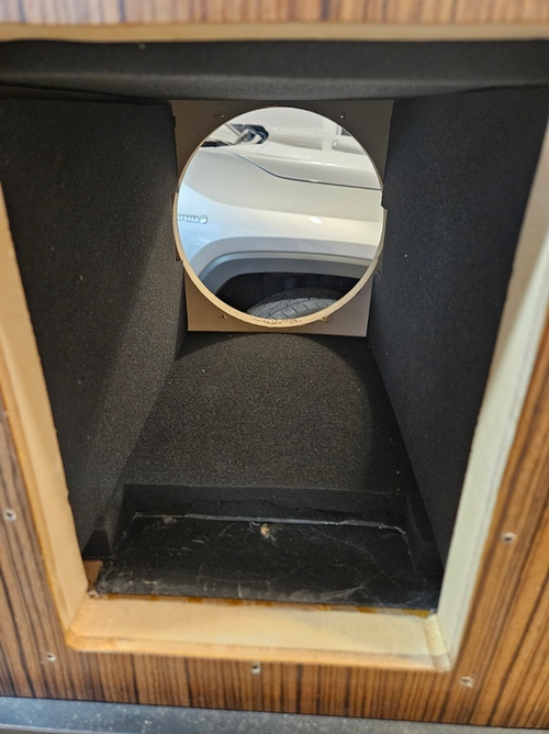

I've decided to reline my Omega Super Alnico Monitors - HO and Rythmik 8" woofer cabs with No Rez.  Danny, thanks for help thus far in deciding to do it and in purchasing the material.
I was lucky since I found the padding layer was stapled in, not glued, which is what I feared.  I will, of course, remove the staples.
I am starting the project today and was hoping to complete, at least the monitors, all in one day so I don't have them out of commission tonight.  But, naturally, I run into questions.  I'm posting a couple of initial photos.  One with existing damping and one with that damping layer removed.  I discovered that there is a thin, but dense, layer of some kind of damping glued underneath (the black layer).  I'm thinking I will adhere the No Rez on top of that to save some difficult removal work.  Anyone see a problem with that?  It is quite thin, maybe 1/16".
I'll report progress and before and after sound impressions later.

Nice speakers.
If the adhesion of the No-Rez is good on that black layer I would leave it there.

« Reply #2 on: 10 Sep 2025, 04:05 pm »
Thanks.  That thin black layer is adhered well, so NR adhesion should be good to it.

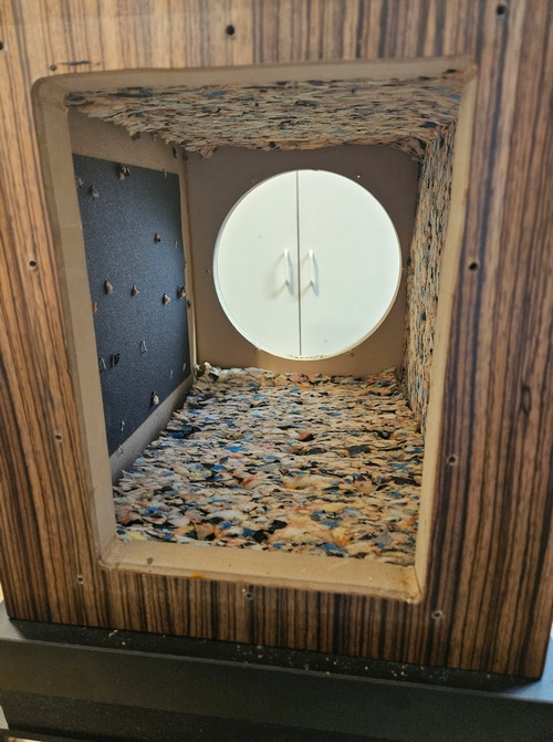

Now I have finished the woofer cabinets.  These are much smaller.  Here are before and after.  The before photo has one side of the original layer removed.  There is a cut out at the bottom to make room for the plate amp:
Again, I've read that the No Rez foam layer does not affect the effective cabinet volume with regard to the sound.  I'm doing integration adjustments to settings but wonder if this is 100% true given that I started with 1 cubic foot.  The thick No Rez reduces the physical space dramatically.  So far, I'm reserving judgment regarding the improvement for the woofers.
However, with regard to the main monitors, there is no question that there is dramatic improvement.  Much more than I was expecting!  Bass is tighter, everything is clearer, imaging is sharper, dynamics/transients have greater impact.
Very happy about this result.  Now on to overall tweaking to get the woofers newly integrated.

« Reply #12 on: 13 Sep 2025, 10:27 am »
I believe that No Rex will actually affect the space sonically different, I believe the drivers behave like there is equal too or a bit more space than without No Rez in the same enclosure, I could be mistaken, but that has been my experience.

« Reply #13 on: 13 Sep 2025, 12:31 pm »
Do I understand you correctly that the No Rez does not reduce cabinet volume?  In fact, either doesn't change it or makes it seem bigger than the actual physical volume?
@Danny Richie, could I get your input on how this works?  Thx

« Reply #14 on: 13 Sep 2025, 12:49 pm »
Go to Danny's website and watch the first video. Beginning at the 5:24 minute mark, he answers your question: https://gr-research.com/product/norez-two/
Got it thanks! I knew I had heard it or read it somewhere but couldn't find it. So no worries for me about the cabinet size; it should be fine as is. The only question now is that he talked about measuring impedance on a ported speaker and my rhythmic woofers are sealed. Wondering if that matters. Particularly since the results on the monitors are stellar but I still am questioning the results on the woofers.

« Reply #19 on: 13 Sep 2025, 05:01 pm »
It looks like all is figured out here. The No Rez is not really needed on the braces, but it also didn't hurt.
