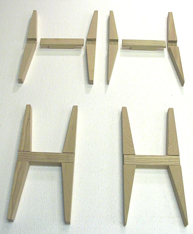

My retrofit braces were tapered because most vibrations are in the center of the panels, non-parallel sides break up internal reflections and tapers reduced the brace size. I used hot melt glue along with Grizzly Xpress polyurethane glue. The hot melt glue held the brace in place until the Xpress expanded and made a permanent bond. The cross pieces were installed after the Xpress dried using more Xpress.
https://www.grizzlyglue.com/
Notice some braces taper to a point, these were installed in-line with the drivers. An easy install if you take your time, measure twice, install once and keep your focus (notches face up). The wood is white oak.
You do the math, and it probably less benefit than you think.
Some of my boxes have tapered edgs but their prime purpose is to reduce the diffration signature of the box. The big chafmers on the front are prt of it.
Those look interesting for retrofit purposes. Not a good idea to place  the brace dead centre. More complex if one brace is insufficient.
Another trick — which i credit to GM — is to run rods from panels and put parallel panels under stress.
dave
Nice illustrations, good info for someone thinking of retrofitting some bracing.
The Von Schweikert VR2's are long gone. The tapered design evolved because if the braces were straight the drivers wouldn't fit, it evolved to an industrial design choice that nobody would see but I knew was there. I think the taper had minimal, if any, effect on the sound. Off setting the 8 braces probably would not have made a big (or little) difference with the VR2's. The (relatively) slow drivers (compared to SEAS and RAAL) were ultimately the weak link in the design. The mods reached their logical end point.
