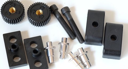

I've built Danny's XLS Encores with upgraded crossovers and tube connectors.  I'm about the build a pair of CSS Audio Triton 1TD-X with superior crossovers for a separate area in our home.  I'd like to have the flexibility of both tube connectors and binding posts on the back of each speaker.  I'm not quite sure how to do this with good connectivity to each.  Jumper wire between the tube connectors and binding posts?  Separate wires from the crossover to each set of connectors?  Other?  Also, any suggestions on a good set of binding posts that are non-metallic.  The posts that come on the CSS Audio DIY kit have metallic nuts and washers while the post itself is non-metallic.  Will the metallic nuts and washers make an audible difference on these speakers.  Thank you!!!

I did exactly what you're talking about with my highly-modified CSS Criton 2TDx speakers. I used a Dayton Audio mounting plate that accommodated two pairs of binding posts and mounted one pair of binding posts and one pair of tube connectors.
I duplicated the crossover feed wiring, running one pair to the tube connectors and another to the binding posts.
In all honesty, I can't hear a difference between the two types of connections.

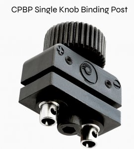

If it were me, I would just replace those ferrous parts off of the cheap binding posts and just use them when connecting to something that has spades or banana on them. Then use the tube connectors as a primary connection.
