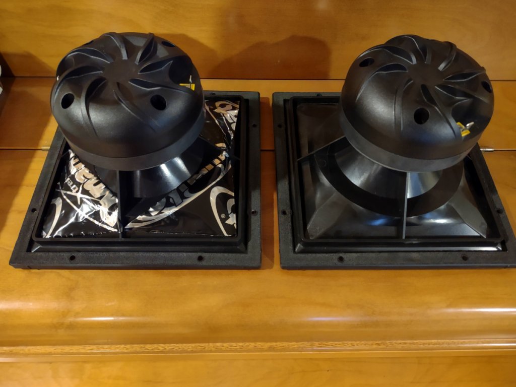

, they each sounded like bongos.  Applied material, dead silent now.
The tweeter is a two part design all plastic tweeter with a rubber overlay, when I pulled off the rubber overlay and tapped the corners or the edges they would ring and vibrate, so I put the rubber overlay back on and noticed that it was significantly quieter but still there.   I am aware that the 8 screws that would apply pressure back to the tweeter but I just want this silent.

Down to last sheet of no-rez, saving for bottom woofer and terminal for both speakers.

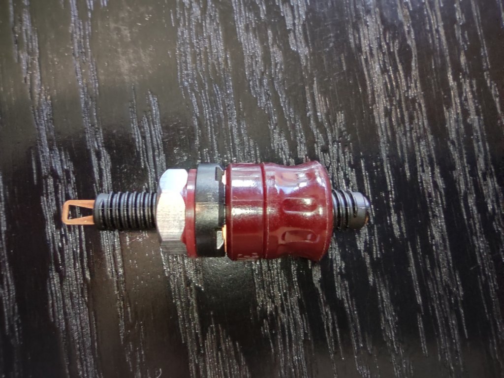

Went with the original planned posts as those AECO were slightly magnetic 🧲

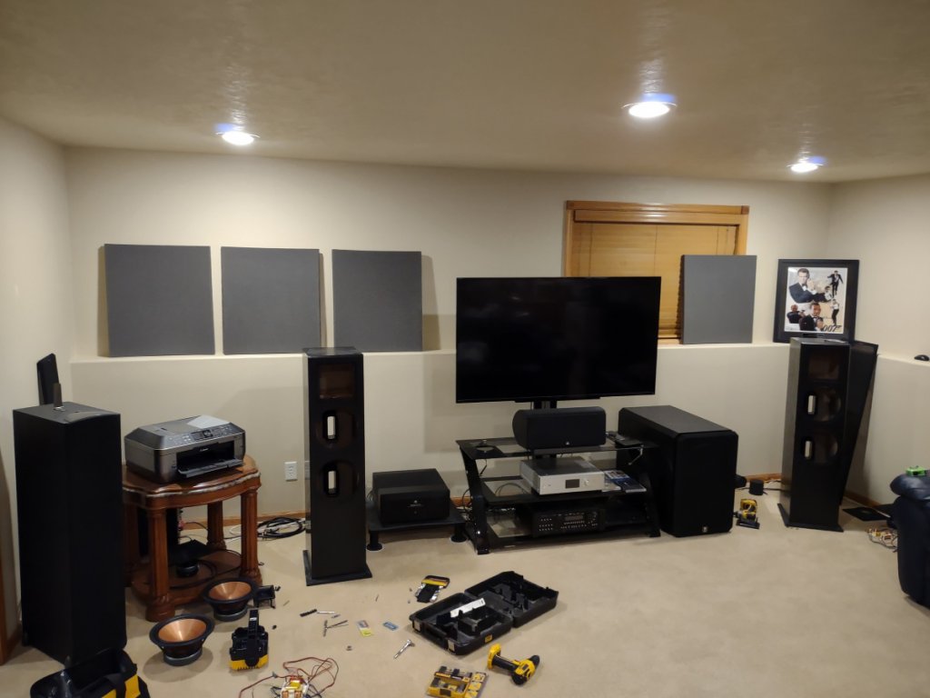

« Reply #29 on: 8 Feb 2023, 11:14 pm »
This actually worked, proved that I need room for treatment.
We use those tube connectors for a reason. They are a much better connection and allow for a cleaner sound top to bottom.
