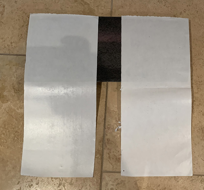

Remove the backing adhesive, and then reapply three of the removed pieces at a 90 degree angle. The following photo shows the first two pieces applied.

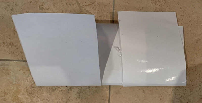

Install a third piece of backing material in the middle and then fold the three pieces over as shown here.

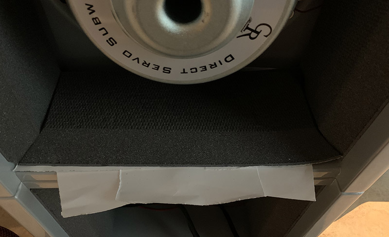

Now you can slide the NoRez into place since the backing material allows it to slide against the inside of the sub. It's still a bit challenging since the foam doesn't like to slide along the pieces on either side, but with a little finagling, you can get it into place.
Once you have it in place, you can pull out the exposed backing material and press the NoRez down.
