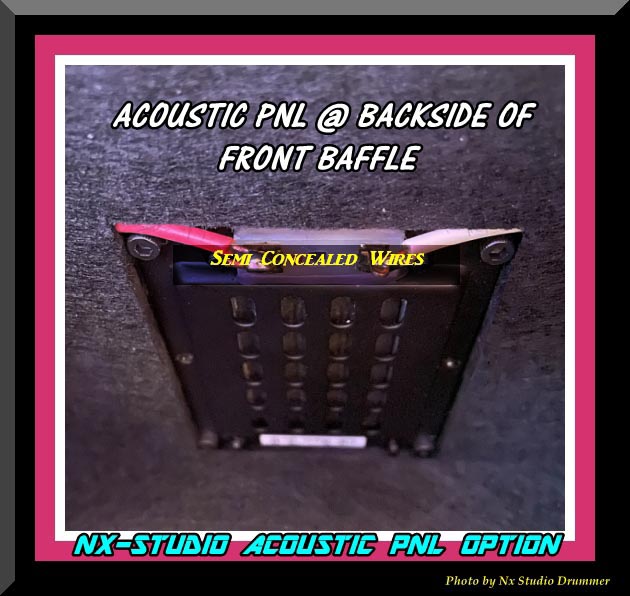

 I suppose I'm overly cautious, when it comes to other people modifying their own speaker projects, based on my suggestions. I know what I like, but I don't want others to be let down. I do show photo's of my work from time to time, but never expect anyone to follow what I've done. My photo's are temporarily posted up, just to display my finished projects. I also don't want Danny to think, I'm infringing on his initial design. Therefore, I feel like I'm stepping on the designer's toes.

I ran out of the thicker NoRez I'd gotten from Danny after completing the interior and ramp of the NX Monitors. I finished the sides of the ramp area and back of the baffle area around the tweeter with thick acoustic felt I had left from another project. This has yielded excellent results. This just might be an area where you can tune with various acoustic treatments to get the best result for your room and system. It's worked here anyway.

I see the top area as a quasi-surrounded area where tweeter is mounted, therefore the backwave having multi-reflective solid area's exposed, the panels may be a solution???  Just me thinking out loud!  I like your observation, which is parellel, to my way of thinking. With various panel size experiementation. The good thing, it's not a expensive tweak.
 I chose the 3/8" Inch thickness for starters. Then press fitting the panels temparary, until I approved of what I was hearing for my smaller room, which worked out successfully. Howerver, some rooms can be livelier than others, so can various thicknesses, be more effective than other? Perhaps subjectively.

( Of course I added the other two screws in the middle of the tweeter in the photo above)
If anyone wishes to learn more about these mod's, just message me, and I'll be glad to help. :popcorn:
Update, after long term listening since initial build, I like the BXI panels results better than the NoRez on the ramp.  :thumb: :thumb:
