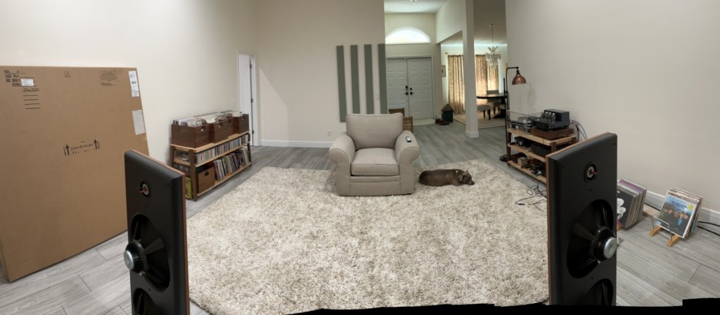

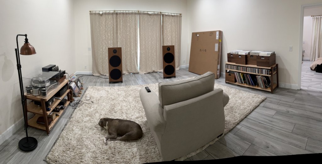

Speakers are about 4' from the front wall, 4' from the side walls, 7'4" apart and my chair is 10'6" from the speakers which is about 7' from the back wall. They look more toed in than they are because of the pano shot. They are pointed to just outside of my ear on each side. I've moved the speakers and the chair around a lot (but more fine tuning can be done of course) and this is where everything sounds the best except the bass along the back wall I'm missing where the chair is. There is some, but not as much.
Have you tried an equilateral positioning?  I preferred the sound of my X5s when I was sitting in an equilateral setup, but I couldn’t keep it setup that way in my family room.  It seems like you might be sitting back too far from the speakers compared to the shorter distance you have between the speakers?  Disregard if you already mentioned it or already tried it.  Nice size room!
  • Posts: 11646
Re: Bass traps for open baffle not really needed?
« Reply #21 on: 22 Oct 2022, 06:34 pm »
Agreed, leave the seat where it is but move the speakers so that they just touch the edge of the rug.  Even if it doesn't change the bass, it should give best imaging and soundstage.

Thanks guys. I took your advice and spent some time on this, this afternoon. I can't wait to listen to it - hopefully tomorrow (wife doesn't like the loud speakers so I usually only listen to when she has left the building which is usually 1-3 hours per week - which is why I'm so annoyed by this 400 breakin for the M3s).
Anyway, here are the measurements I wound up with - digital.
Room is 19.78 long and 17.56 wide.
left ear to speaker is 9.226
Right ear to speaker is  9.130
distance between them is 9.127, measured from centers of tweeters.
each are 4.5xx to the side walls
each are 5.5xx to the front wall (hard to get exact measurements with the curtain wavy)
ear to rear wall is 6.575
I'll report back again once I listen....looking forward to it.

The room looks like it has the bones of a great listening room, but I would expect it to sound very hard and edgy at first glance.  There nothing but walls and glass in there.  The new placement should help when you get a chance to hear it, but you really need either furniture or a lot of treatment.  The idea with the speakers closer is to reduce early reflections by increasing the percentage of direct sound.
Also, removing the deceased dog should help with the odor.
