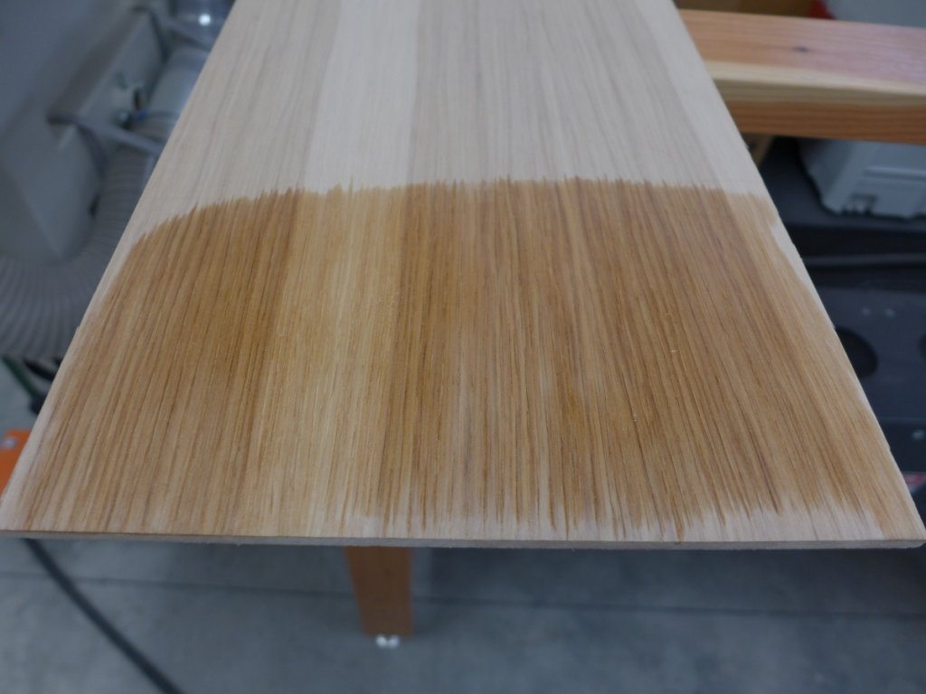

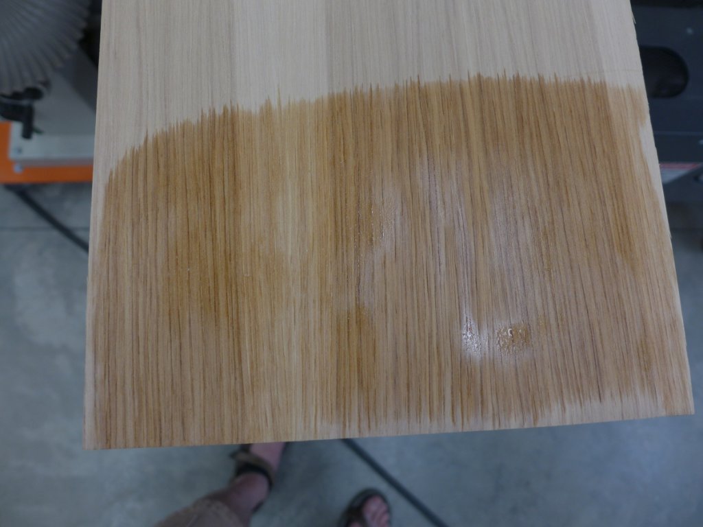

This is from memory, but Hickory might get you in the ballpark. Sometimes called Calico Hickory, because of the varying light and dark. I wetted this with thinner for a better idea of what it would look like. It's a little nasty to work with, being hard an somewhat brittle. Prized many years ago for tool handles. Axes and shovels, etc.

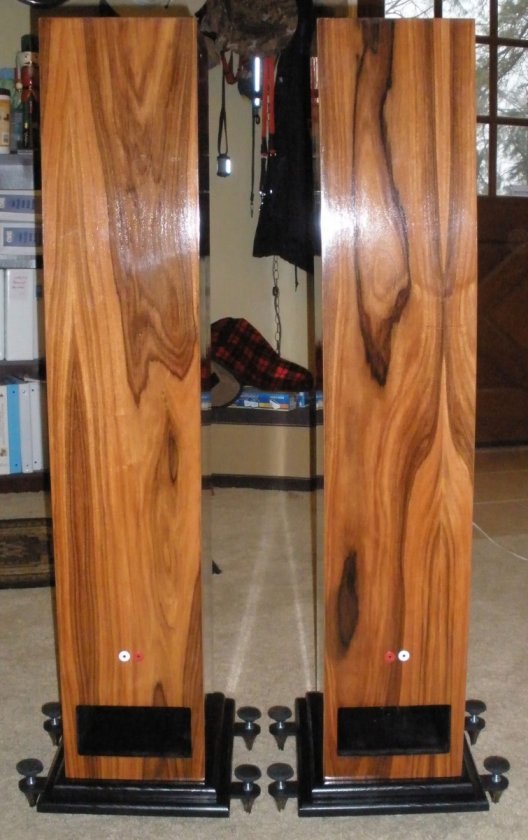

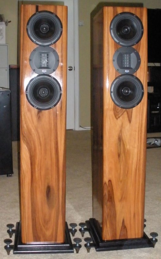

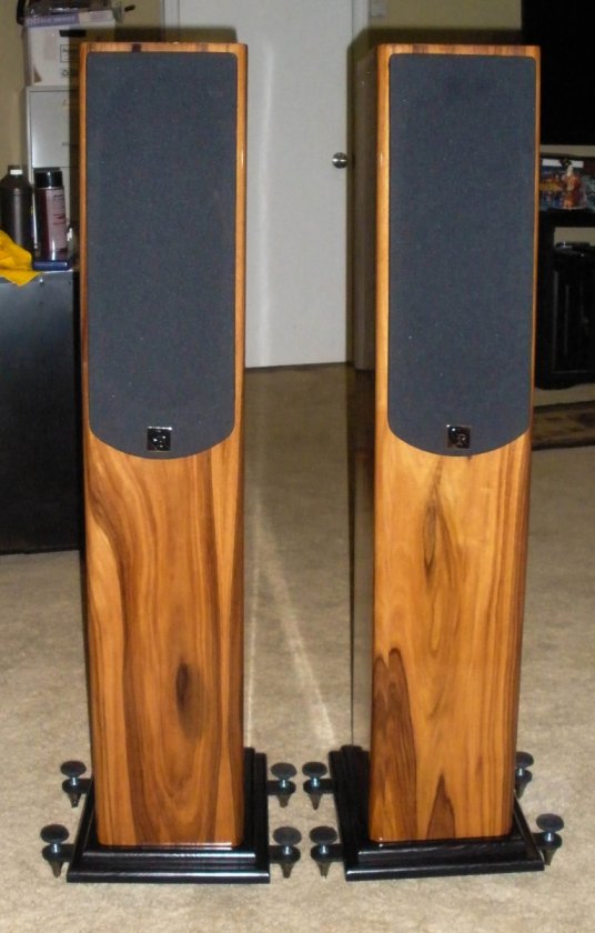

Here's Pau Ferro / Santos Rosewood with a Super Blonde Shellac finish on a pair of GR-Research N3's

« Reply #10 on: 19 Aug 2021, 07:08 pm »
Gorgeous!
Been listening to a pair of N3s the last few days they're a great speaker.

Beautiful work Mike!  Those look amazing!

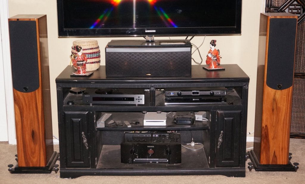

I've had these for 7 years and listen to them almost daily. They're in the living room system. Which my wife informed me when I hooked these up for the first time, was her system and these were her speakers. I could go build myself something else.

Absolutely. These actually are a very high gloss rivaling piano gloss lacquer. My photography skills are lacking so the pics don't reveal it.

Your photography skills are fine, I can see how glossy the finish is just by looking at the reflection on the sides in that shot with the system stand. Like a mirror, that's really nice. Did you use a traditional wool pad when rubbing that in?
