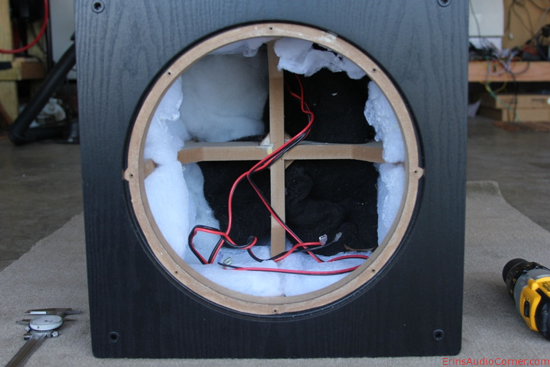

I found this review that shows pics of the F12G including the insides, measurements etc.
https://www.erinsaudiocorner.com/loudspeakers/rythmik-f12g-direct-servo-subwoofer/
Its not built to the same specifications as Dannys, or even the L12, which I have, but it's a much larger cross brace and jas a lot more stuffing than my L12 was stock. But it definitely looks thick.
