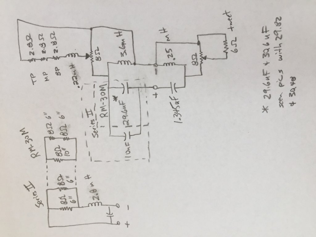

PS You could test the drivers individually. They are wired in series so you could remove two of the drivers by either putting a 6 ohm resistor in place of two drivers and test or just jumper past them without 6 ohm.  If I recall the positive comes to top panel, so you would remove the negative lead from that panel going to positive lead of center panel and then jumper to negative lead of top panel to negative lead of bottom panel. From there run some sine waves (or music) and listen or better yet run some sweeps using Room EQ Wizard (REW), then move panel and repeat with next panel, and the next.
PSS Just looked at the schematic and the positive is going to bottom panel not top. That said, an easier way to test the panels individually (to minimize removing connections) is to put a jumper across the two terminals of the other two panels. To test top panel put a jumper directly across the plus and minus leads of middle speaker and a jumper across the plus and minus leads of bottom panel. Then test. Remover power and move jumper from middle panel to top panel to test middle panel, same method for bottom panel. This ONLY applies to the RM-30 which are wired in series and NOT RM-40 or RM-V60 where the panels are a combination of parallel and series circuits.

RM-30 schematic:
