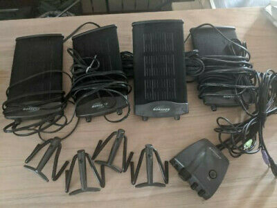

Not a great picture, but these look correct.
https://www.ebay.com/itm/MONSOON-MM-2000-Awesome-Flat-Panel-Speakers-60-Watt-Each-W-O-Subwoofer-/143631761321

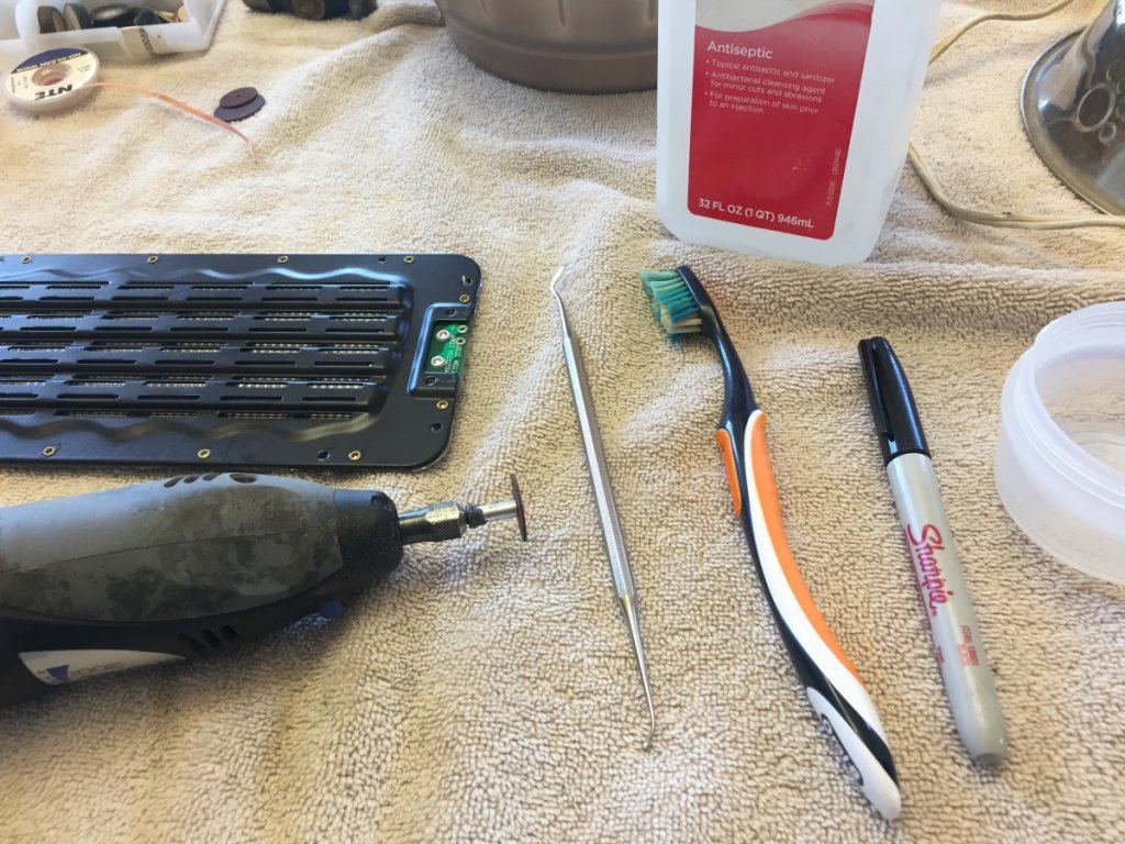

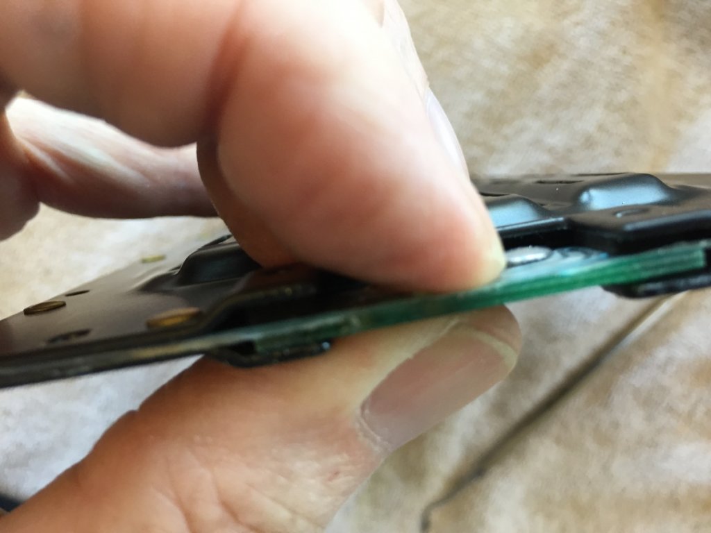

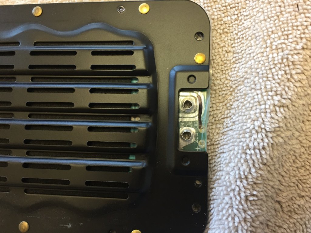

This is supplemental information on re-purpose panels to support your VMPS speakers. Post #4 above described what to look for and purchase, here is how I removed rivets and replaced with #4 screw, nut and spring washer and #4 ring terminal for 14 gauge wire Molex part number 19069-0099.
This is my experience and is for guidance only so if you mess up your panel its on you.
The idea is to remove rivet while preserving the integrity of the tinned copper foil on the ring terminal (back) side of neo panel.
What NOT to do. Do not drill out rivet with drill as the rivet will likely turn with drill bit when it starts to become loose and subsequently tear up copper foil.
I used a Dremel with cutting wheel. Wheels are usually larger so I wore it down to a smaller diameter. I removed material from rivet with the cutting wheel on opposite side of rivet head until I was close to board. I then took a dental pick and removed the last bit of material. I then placed my finger on the copper foil side to hold foil against circuit card and gently pressed out rivet. Copper foil was perfectly preserved. I touched the wheel on a neo case so I used a indelible Sharpie to bring it back to look like new. Cleaned everything up with isopropyl alcohol and tooth brush.
Below are pictures of tools used and process.
