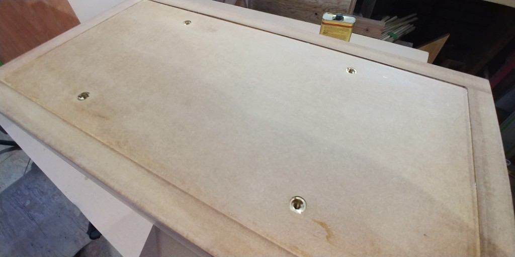

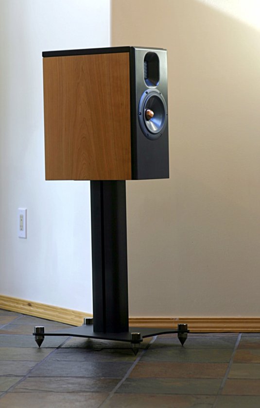

This is what I did on the NX-Studio Monitors I just completed. First get the dimensions of the base of the speakers then find a stand you want to use that has a top plate that fits within the speaker bottom. The size's are listed when looking at stands. Then once you get the stands in hand use them to lay out mounting holes on the speakers then drill and install threaded inserts. Get matching bolts for the inserts you choose that fit the holes in the stand. The bolts do not go all the way through the bottom of the speakers thus no issue with damaging the crossovers.
These stands are from Elac for their Adante' speakers. I like them because they are heavy duty, can be filled with sand or whatever and that Elac does not put their name on them. They are 23 1/2" tall and have adjustable spiked feet and come with nice beefy floor protectors. They may be perfect for the MTM based on what I have seen of them. They retail for $299. USd. I picked these up from Music Direct as an open box clearance deal for $240.

Oh man, those look very nice. From what I can see you did a great job.  :thumb: :thumb:
