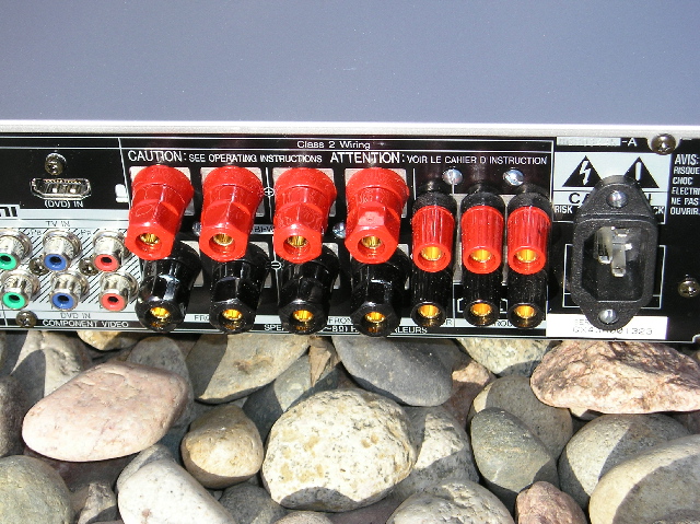

At long last the SA-XR70 mod is finished :D
For this one, I modded out the power supply, main amp board and analog input board. The binding posts and spring clips were replaced with Superior Electric, direct gold plated, 30 amp binding posts.
The power inlet was replaced with an ACME Audio Silver Plated IEC.
This unit also has Bybees in the main speaker positive lines. I ran NITRO speaker cable direct from the amp board to the main binding posts. For this one, the bi-amp relays were removed for the best sonics in straight two channel.
A mod of this type, without the Bybees would run $800.00. To wire up the relays to allow Bi-amp operation, the cost would be $900.00.

« Reply #6 on: 27 Jan 2005, 10:52 pm »
Question, since Bi-amp relays can be removed, is it possible to wire up the XR70 with a 6.1 binding post configuration by using the "B" post bank?

« Reply #8 on: 27 Jan 2005, 11:10 pm »
Quote from: JnC
Regards,
JnC
Yes.
The SA-XR 50 AND 70 could be wired up that way if you do not wish to use the "B" speaker position.
In fact, there would be one extra set of terminals then. You would have to decide what connectione go to what binding posts. I would say maybe the center front and rear can be hooked up to the "B" speaker posts.
