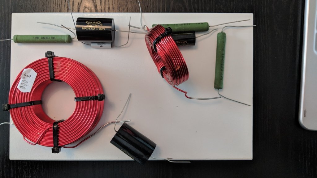

Ok I've gotta admit, I'm struggling a bit on the crossover for the X-LS Encore. I can barely get the second Erse cap to wrap the ends of the resistor ... I've got a max crossover board size of 5-1/2" x 9". I slid it in and it fits, barely.
This is the best layout I could come up with. Obviously, I'll make it look nicer than this, but will this work?
Danny Richie
Check this out.

Ok so turn the  tweeters inductor so it's 90 degrees from the woofers? What about the rest?
Danny Richie
Twist together the inductor in the woofer circuit and the resistor in the tweeter circuit on the input side so that you have one input connection.
And follow the connection instructions here: https://www.audiocircle.com/index.php?topic=83325.msg805156#msg805156
Ok, didn't know I could do that. Thanks!

And don't miss this part about the negative wire: https://www.audiocircle.com/index.php?topic=83325.msg805419#msg805419
Yeah that's exactly what I was going to do :)
