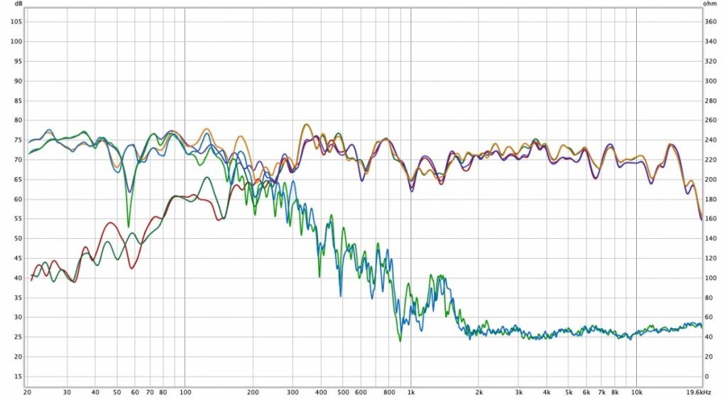

My P.I. Audio Group power cable for the PS Audio Gain Cell DAC came yesterday and I am working on breaking that in. I used the EQ function on the A370 amps to tame the peak at 43 Hz, which isn't going to be fixed by adding more traps because it's so low in frequency. The PEQ works well for this and flattens it right out.
Above is the L+R channel with and without the PEQ engaged.
I'd still like to eventually get a GR servo sub (a sealed one) positioned out-of-phase behind my PLM. I suspect this will help to "remove the back wall" since I don't have the luxury to sit too far away from the back wall and can't put diffusion there as I would normally do in a room to tame the rear-wall reflections.

Keep in mind when trying to even out the response to just look at one speaker at a time. If you play both of them at the same time then you can get peaks and dips caused by the time arrival differences of the two speakers and their room reflections.

Yes, Danny, good point. The plot above was just the combined to show the effect, but I set the PEQ for each A370 independently to flatten each channel first and then also measured together.

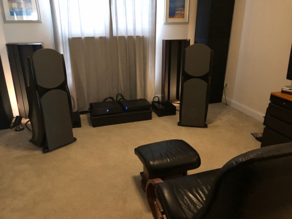

I added a new picture of the current set up after adding in two GIK QRD diffusers behind the Vs and a additional bass trap behind the listening position.

I played around with positioning today after reading Lynn Olson’s article on ideal speaker positioning. Basically, I decided to bring the speakers into a 6’ equilateral triangle and toed them in much more such that they crossed about a foot in front of my MLP.
Originally I had these about 8’ apart. So I moved them each in about a foot. Sub amps were tweaked a bit as well. I need to do more listening but it’s an improvement. One of my biggest challenges with the Vs is their phasey central image. This helps a great deal. Plus I still have imaging outside the speakers.
This also seems to address some issues with a 370hz peak I have in my room and extends the response up to 20kHz.
