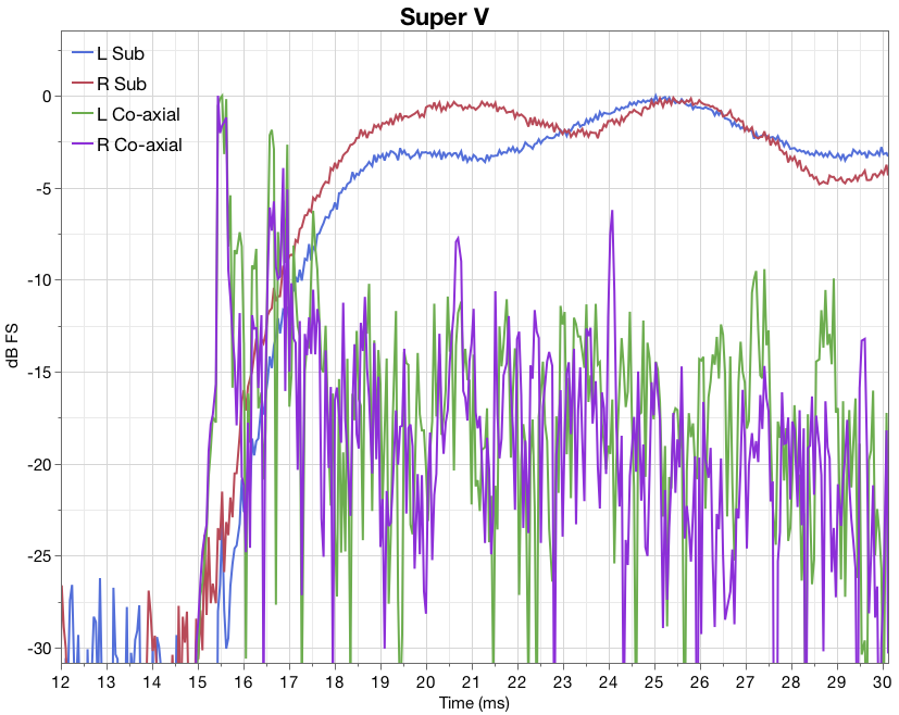

So this is the early part of the ETC for the L/R co-axial drivers and L/R subs (old sub settings). What I see is that the arrival time of the sound from the co-axial drivers are at 15.5ms or so whereas the subs arrive later, tough to see the direct sound peak but maybe 20.5ms? So if I am reading this right, I need to move the sub arrival signal ahead in time by about 5ms to arrive blended with the co-axials.
When you turn the delay/phase from 0 to 180, are you increasing the delay? How much delay range are you adding going from 0 to 180? Period of 80 Hz is 12.5ms so would the range be 6.25ms of delay @ 80 Hz? Am I thinking about this right?

Since the speed of sound is about 1130ft/sec, 5mS of time offset equates to 5.65' of travel distance difference.  If you expand the first impulse you will probably find all four peaks overlapped,tweeter, mid, sub 1 and sub 2.
Those other peaks are room reflections

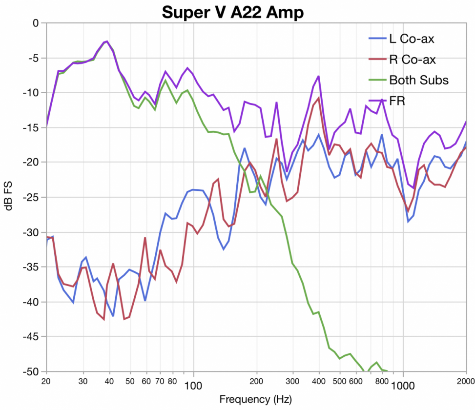

Also for whatever reason this amp lets the 12" dig down a little bit deeper, so I am getting a much better blend with the subwoofers.

Plus look, I am finally getting a proper cross over between the subs and the co-axial drivers. Nicely summed through the XO region.

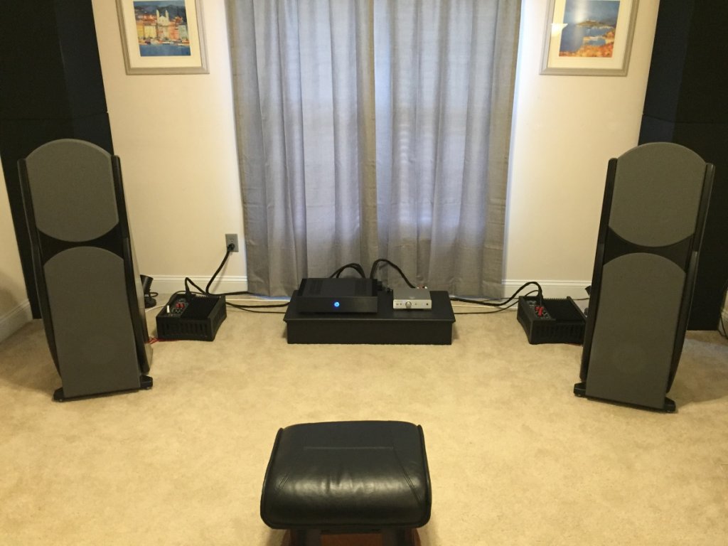

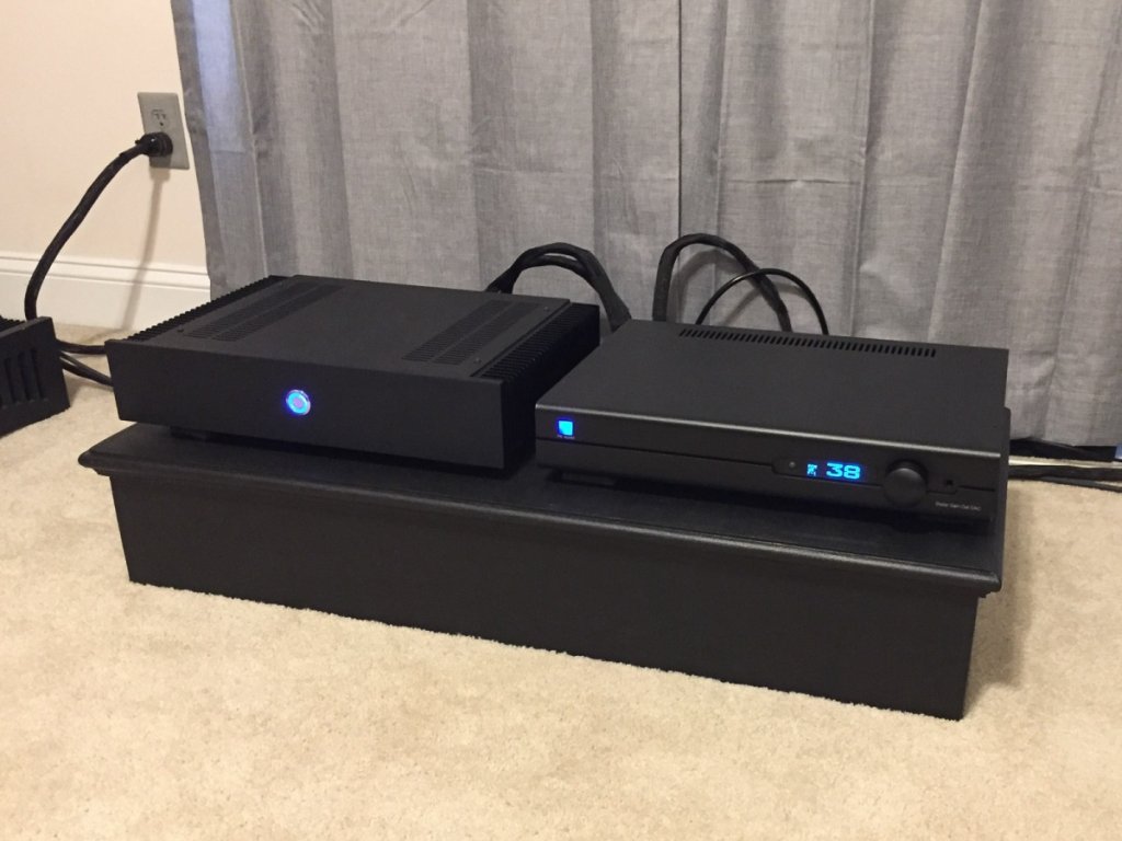

Updated system pictures. Here is that chip amp I am using:
Also I forgot about that little Folsom Amp (https://www.audiocircle.com/index.php?topic=156151.0) that Danny built a few weeks back. The one in the nice Dodd case. Another option for good pairing with the system.

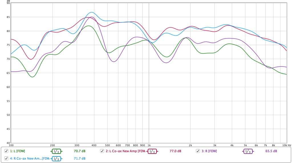

Current FR after adding the PS Audio, additional bass traps and XLRs.
