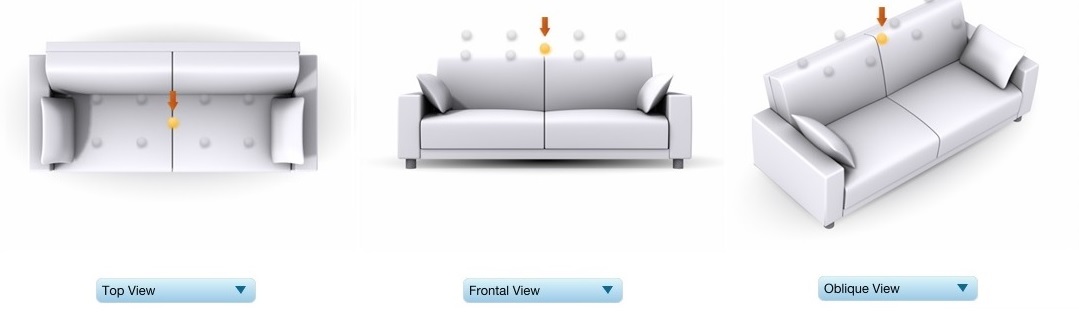

Nick,
What positions were used for the microphone? Was the mic height on the tweeter axis?

I followed the Dirac Live guide for "sofa" measurements as closely as possible.
What you see is the measured average of the 9 positions.
Position one was measured at my ear level in the dead center of the sweet spot.
Then there are 4 measurements to the left and 4 measurements to the right of the sweet spot.
Two are slightly below and two are slightly above ear level on each side of the sweet spot. I only moved about 2 1/2 feet left and 2 1/2 feet right of the sweet spot for all the measurements. My ears are pretty close to dead on with the tweeter height.

Thanks for the additional information.  The bass peaks are from the room modes as well as the extra reinforcement of the corners. The dip in the 200-300hz range is often due to a floor reflection. With a cancellation like that you don't really want to try to correct it because it eats up amplifier power and won't really help the situation. As a rule it's always better to cut than boost but in doing so you lose some overall output.
