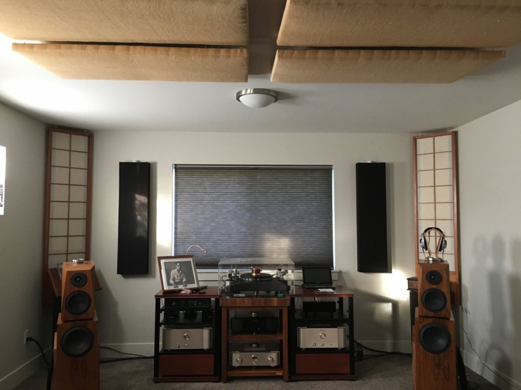

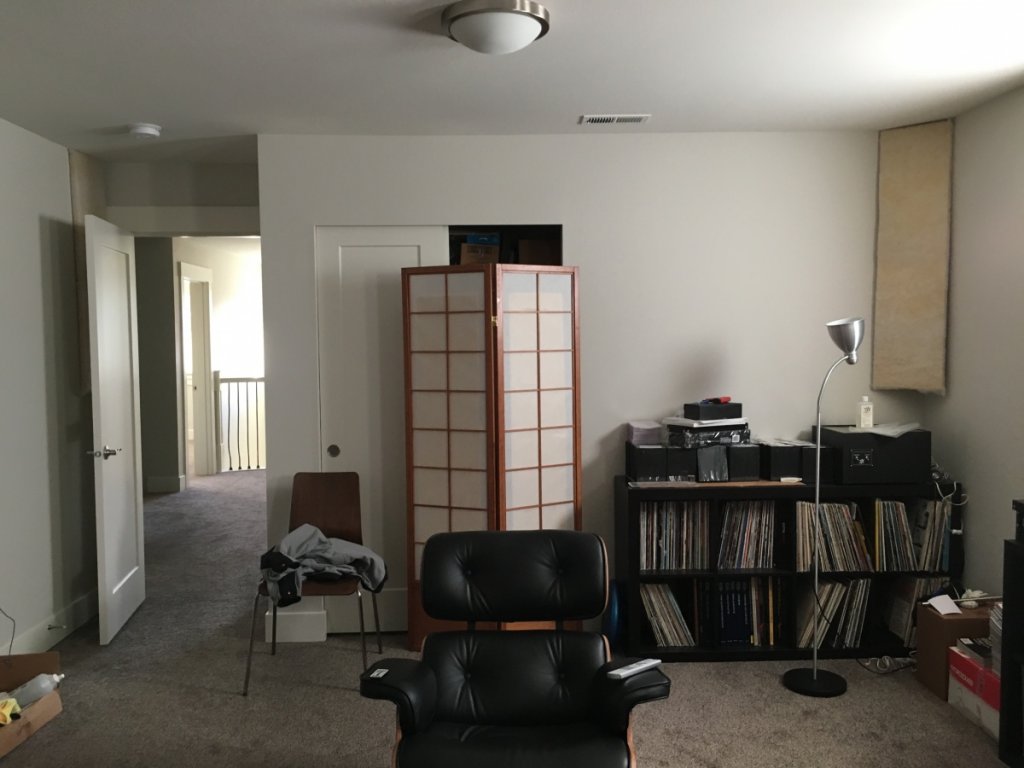

Thanks Bob...I will shoot Brian an email and hopefully connect with him....I will give an update.
But just a little bit of information on the room dimensions, it's 19x13.8x8 feet with about a 3 x 3 x 8 feet at the rear right corner for the door.
I have some DIY 1" fiberglass board absorbers on the ceiling, at first reflection, wrapped in burlap.  There are four panels of 2x4ft by 1 inch thick.
In the front corners I have modded some Japanese room divider screens and added 1 x 4 ft by 2 inches thick behind the screens as a corner trap.  Also in the front wall is a 70x60 inch window, smack in the middle that has a double layer of honeycombed blinds on it.  To the sides of the window, between the screens and window are 1 each side of the Roomtunes aborbers.  These absorbers are also at first reflection on the sidewalls, each are 1 x 4 feet by about 3 inches...
In the back I have the same screens in the front corners, but with only 1 layer of the fiberglass boards (1 inch thick by 1 feet wide and 4 ft tall)...
So far, the biggest difference I find are the front corner screens and the side first reflections as well as the ceiling absorbers...
I will post some pics for visual perspective...

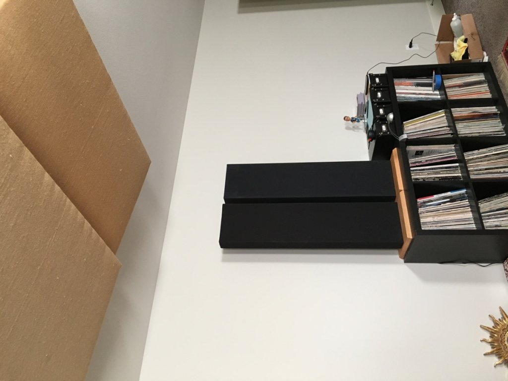

Here are some pictures, Front, Side and Back... :thumb:
Bob2
  • Posts: 1855
rodge827, tried to send these via pm but didn't work out.
Cannot say with any authority how well these work. It started as an experiment.
I have two panels so far. Since they are cheap and easy to make I'll make a few more panels and see where that takes it.
Yes they do smell nice. No more moths either....
