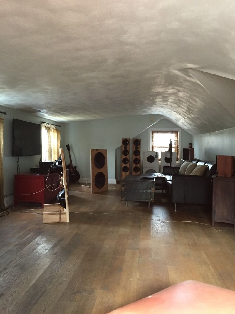

I've been reading up a bunch on treatments. It's still a bit confusing but the more I read the more it will sink in.
I've got some special circumstances going on, in that I use OB speakers and my room is oddly shaped.
I ordered a case of OC703 yesterday and I have the needed skills to DIY what ever.

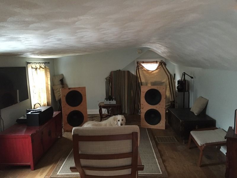

This is my newly dedicated HT room.
I just removed the couch in favor of a couple of Poang chairs and slid the coffee table between them. The sonic difference was pretty depressing, and I wasn't that impressed to begin with
I had a pretty decent wall of sound but I want more separation. I really want the best I can get away with.

Should I mostly ignore the opposite end of this room? It's roughly 15x35 and the ceiling height in the center is 6'5"
My office is at the opposite end.
Am I going to leave the front wall alone because of the OB? Just put a bass trap in the 1st corner?
That ceiling! Can I make it work for me?
I'm 5'8 so it works OK for me.
Also I can alter where I sit if needed. Meaning I could move the electronics to where the extra speakers are currently. Maybe even put the electronics where the couch is? Or use the short wall instead?
That V in the ceiling to the right is a hall way to another room.

1st pic now has couch replaced by poang (minimal) chairs and a small rug

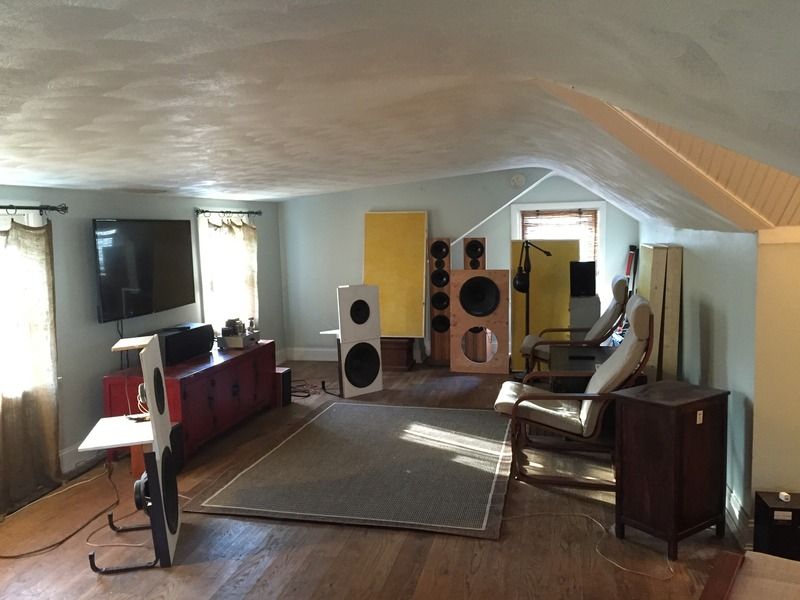

2nd pic was the next attempt at better sound. I didn't want to rip the whole room apart for the experiment. The sound stage was even smaller. Not surprising I guess.

Here is where I am at as of last night. The sound is back to as good as it was if not better, from when I removed my couch and things got ugly.
I know the rug is too small. It was a cheap band aid until I can find one that I really like.
