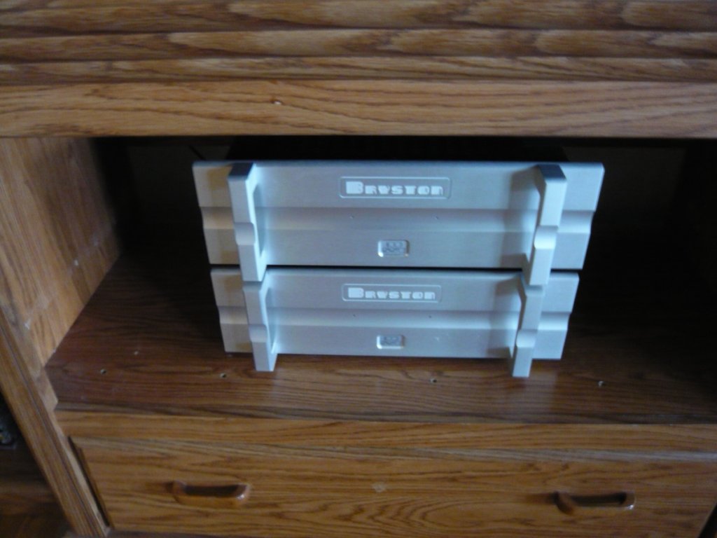

My 28's are stacked out in the open and no issues. I think there is probably a bit more heat generated than if they weren't stacked because I believe the heat generated by one feeds into the other and vise versa, particularly the bottom unit into the top unit.

The "bit more heat generated" is the reason I would not stack my 7B SST2"s or any other pair of amps.  The additional heat over time will diminish the lifespan of the amps.  I'm not saying right or wrong, that's just my $.02.  If you do decide to stack I would swap amp positions every now an again.

I don't think that would be a good idea as it would block the vents at the top of the bottom amp.
My amps have been this way since I got them in the fall of 2013 but next Spring I will be separating them so one goes over by my right speaker plus they'll each be on single shelf Rack of Silence stand.

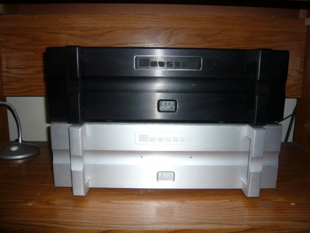

My 3bsst stacked,no issues
set now using
