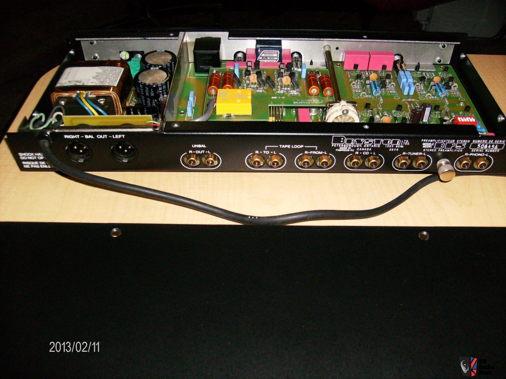

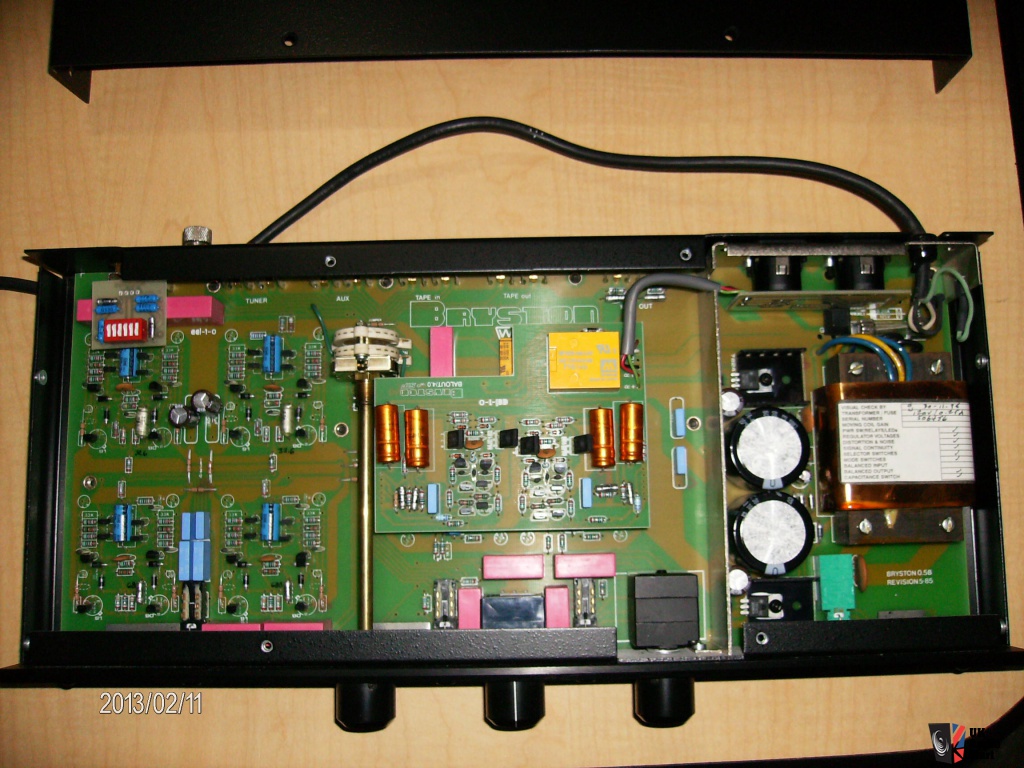

I’m sure Mike has seen more than his share of weird things coming into Bryston for repair ...... but came across a few images that should help clarify the missing board.
http://www.ukaudiomart.com/details/649044998-bryston_bp5_preamp/images/541419/
Don Sutherland
  • Posts: 3
Re: Bryston 0.4B/BP4 preamplifier
« Reply #5 on: 13 Mar 2015, 02:58 pm »
Thanks Rob, that photo is very helpful. Hopefully, I can find artwork for the board or a photo of the tracks. It is a single-sided board, so it should be easy to duplicate. I would like to make this preamp as close to original as possible.
