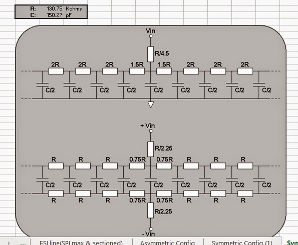

Screenshots from the Segmented ESL Calculator Excel spreadsheet:

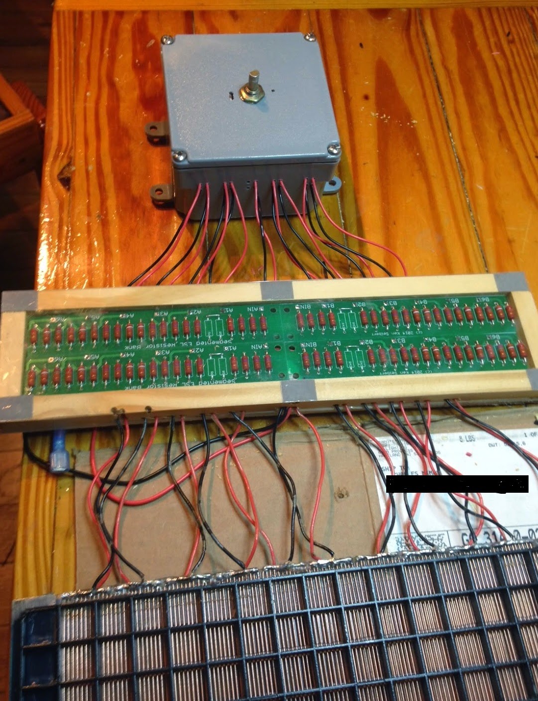

View from the back showing the resistor filter network feeding the panel segments:

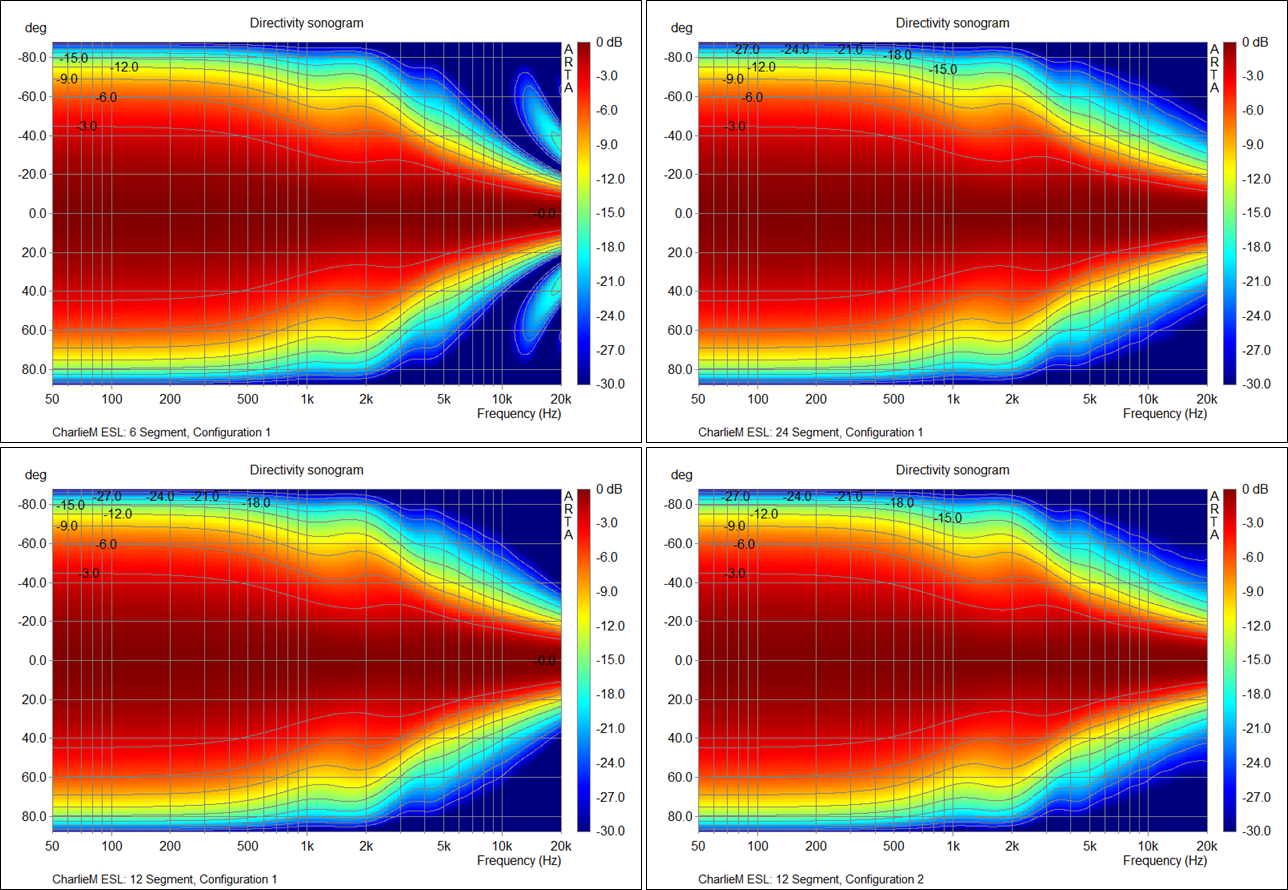

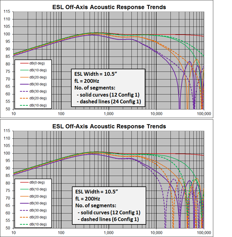

BTW, an ESL guru on the DIY Audio forum who developed the Segmented ESL Calculator I used, ran some polar response sims for me, which I've attached below.   When you're a math dummy like me, it's nice to have smart friends  :thumb:

Hopefully this weekend I will get the switches wired in to enable selecting the [direct coupled] narrow dispersion mode.  The switches aren't shown in my schematic below, but would merely jump the resistors to couple all wire groups directly to the amp/transformers.
For power handling I used at least (4) 2-watt metal film resistors in series between each segment, adding to the value specified by the Excel spread sheet calculator for my panel configuration:

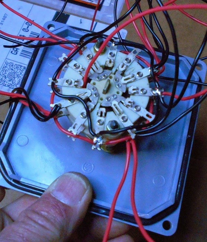

Last night I installed rotary switches to select wide or narrow dispersion-- so now my new segmented ESL's are finally completed.

El Cheapo Soviet military rotary switch (mode selector):
Mode switch box, resistor network and panel connections:
