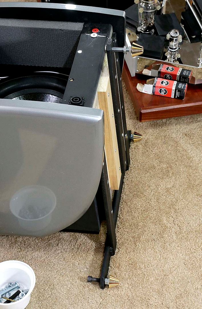

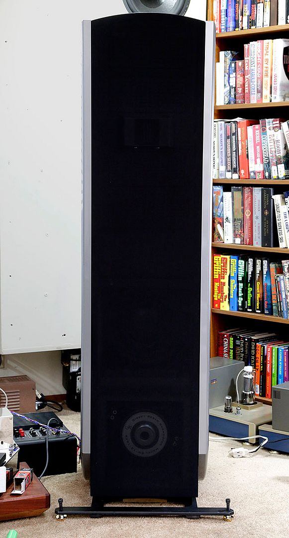

The combination sounds QUITE good, altho I'll be having Sonic Craft do a bunch of parts upgrade in the amps soon.  One thing I did not like about the S-7's appearance was that swoopy foot, so this weekend I built a new pair of stands.  I have a bunch of 1-1/2"-square aluminum tubing and was going to use that but decided on 3/8-by-1-1/2" steel strap.  Bought the stuff and had it cut into the right lengths.  My friend and I drilled holes, he welded the front assembly together, and I drilled and tapped the spike holes.  I used 2-piece, 1-1/2" spikes from Sound-O-City/OregonDV...
http://www.oregondv.com/spikes.htm
...but for 3/8"-course-thread screws.  I used black allen-head screws with jam nuts.
I moved the speakers maybe 8" towards the front wall and rotated them to point directly at the listener.
The sonic results after a short listen are a more-even...seamless...soundstage laterally.  Lucky me.   :D

[quote  One thing I did not like about the S-7's appearance was that swoopy foot, so this weekend I built a new pair of stands.  I have a bunch of 1-1/2"-square aluminum tubing and was going to use that but decided on 3/8-by-1-1/2" steel strap.  Bought the stuff and had it cut into the right lengths.  My friend and I drilled holes, he welded the front assembly together, and I drilled and tapped the spike holes.  I used 2-piece, 1-1/2" spikes from Sound-O-City/OregonDV...
[/quote]
Those look really nice and please keep us posted on your impressions once you've had them for a while.
For my Super V, Super 7 look a likes I'll be doing something similar with the bases as well, I too have never cared for the feet but really like the rest of the Super 7 shape. Nice way that you handled the change.
