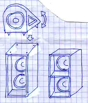

Hi Danny and all Audio Circle members.
I thought of what might be an easy solution to the problem of vibrations from the double woofers transmitting to the top driver (Coaxial or full range).
See the left sketch below and tell me what you think.
At the same time, what do you think of the right sketch?
If there is no horizontal separation between the top and bottom sub drivers,
do you see a problem with that?
The whole constrution is double 3/4" MDF everywhere.
Guy 13

Not a great idea. Spikes don't have any give, so how would they stop the main panel shaking from the bass cabinet vibrations?
If you want something easy, buy some sorbothane feet off of Amazon, stick 'em on the bottom, and done.
If you really want isolation, look at Siegfried Linkwitz's new dipole. LX521 or something like that. He uses the best possible decoupler: empty space, by means of a "bridge"  that leaves a gap between woofer box and the upper panel.

Guy,
Whether you use spikes to anchor it to the cabinet below or glue it to it makes little difference. The outside edges of the cabinet below are going to have very little resonance issue at all, especially being 1.5" thick.
And the resonance frequency of each of the panels on the H frame are higher than those woofers will be playing. They are subject to flex from pressure but making them 1.5" thick controls that very well. A front panel for the upper driver mounted across the front upper panel of the H frame further strengthens it and keeps it from flexing. Lining the panels with No Rez or any good damping layer will also help.
I lot of people tend to think that using floor spikes on a speaker is de-couple it from the floor or whatever it is setting on. That is really not the case. You are really coupling it to the floor or cabinet below. And that is really what you are looking for. It needs to be solidly anchored down or with the full weight isolated to small points (spikes) to further keep it from moving.

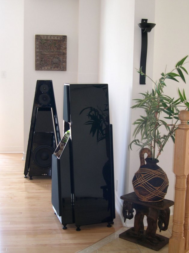

A better bridge ? Interesting stylish two piece.
Gershman Acoustics
Black Swan
$30K circa 2005
Danny Richie
Re: setting speakers on top of subs?
« Reply #31 on: 15 Nov 2012, 04:28 pm »
Gershman Acoustics
Black Swan
$30K circa 2005
Those do look good, and should be very effective.
