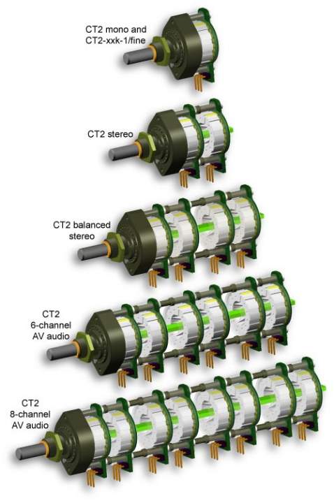

www.dact.com/

Thanks Prelude.
That's a variable attenuator ... looking if anyone knows of an exellent fixed attenuator to keep things pure and minimalist.
