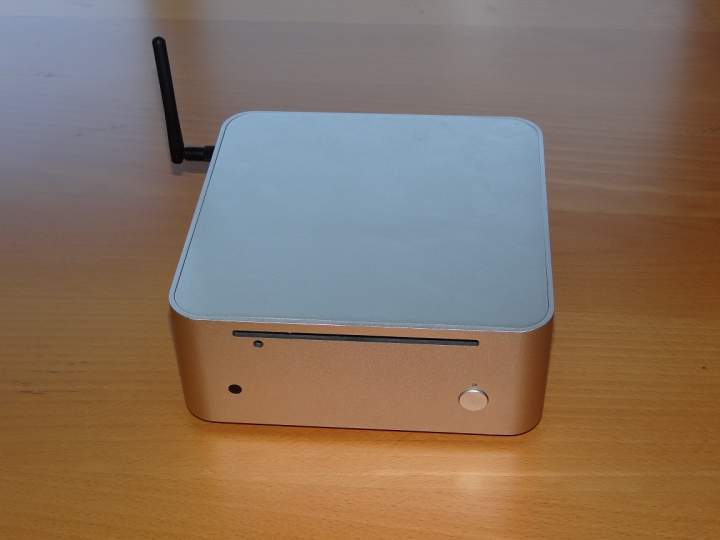

First off the Wesena ITX2 case is absolutely tiny (7.75” x 7.75” x 3”) and built like the proverbial tank, and I think it looks fantastic.  The supplied bracket has mounting holes to mount two 2.5” drives and one slimline optical disk drive.  It has convenient screw access holes to make assembly easy.

I installed the optical disk drive on the mounting bracket with 4 screws.  I don’t have the drive bezel yet and it is required to use the case’s eject button so I’ll just use software eject until I get the bezel.  (It is the only part I had to source directly from China.)

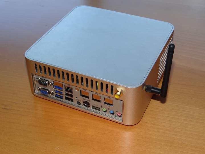

I then added the RCA S/PDIF jack and the antenna mount to the case.  The case had a hole for a wireless antenna which I enlarged to ⅜” accept the RCA S/PDIF jack.  I drilled a new ¼” hole for the wifi antenna.  I am only using one but can add two more later if I find I don’t have enough wifi bandwidth for higher bit rate files.  I plan to use mgalusha’s FLAC -> Wav loader tool so that should not be an issue.  The aluminum case was easy to drill through and it looks like it came with the jack installed.  I plugged the antenna pigtail onto the wifi card and the 2-pin cable onto the mobo S/PDIF header.  The only soldering required on this build was soldering lead wires from a 2-pin digital cable onto the S/PDIF jack.

Lastly on goes the top cover which is attached at the corners with embedded magnets.  (pretty neat)  Next post will be booting the system and installing software.

Since the original picture was taken I have tightly twisted the S/PDIF wires.  I chose to use the S/PDIF out for several reasons: to be different, everyone uses USB and I wanted to see what was possible with S/PDIF, and because I want to use an external DAC.
I have since run into an issue that will preclude 24/192 playback.  The Realtek ALC662 6-channel HD audio chip on this mobo only supports 24/96 playback.  To get 24/192 playback with Realtek HD audio you need one of their 8-channel chips.  :(
