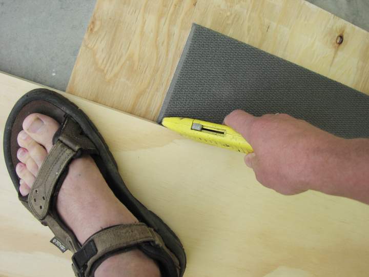

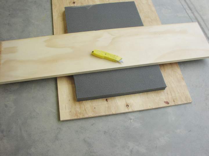

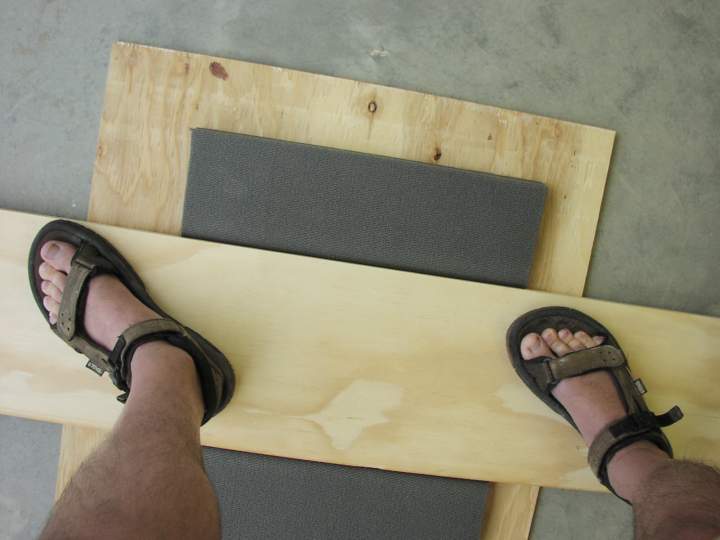

Low tech, fairly high precision, doable in your living room.  Good method if your friends aren't accustomed to calling you an "accident waiting to happen"  :)
New blades for the utility knife. Sacrificial backer can be almost anything that won't kill the knife. Guide should have one straight edge and probably be 3/4" or so for rigidity. Squashing the foam makes for easing cutting, same goes for insulation or batting. one could use clamps instead of body weight, but where's the fun in that?
  Pics tell the story, me thinks:

 :nono: Might want to wear some shoes to cover the toes when doing that...

That picture looks like a perfect set up for a rapid visit to the ER.

That would work for one sheet, but you really don't want to 9 like that.  Get a saw- even a plan hand saw would work, but powered is better. I think that HTcOz may be right about the $20 Harbor Freight gadget.
