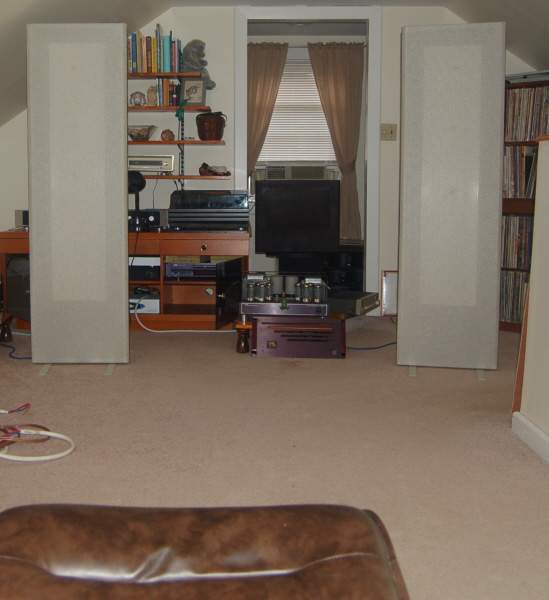

At first we hooked it up to my 3.6s and it was just about useless.  I need this because why?
We then took it upstairs and tried it with 1.7s, 1.6s and finally MMGs.

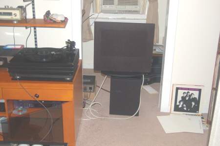

We set it up roughly in the center of the speakers and forward towards the listener about 14" and with the both the 1.7s and 1.6s it made the sound worse in my room - it just confused the bottom end and made everything sound muddy.
It was almost wonderful with the MMGs but nothing to get too excited about.  Maybe a real center speaker would be the answer, I thought, not this woofer.  It might work with the Mini Maggie system but not with the bigger boys.
Paul left and I told Wendell that it wasn't the most wonderful thing I ever heard and he asked if I tried the supplied resistors to reduce output?  Well, no....

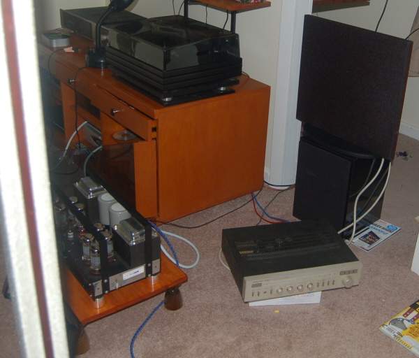

I poked around a little bit and had a NAD 3020 integrated amp and a Harman Kardon PM640 integrated kicking around so hooked up the NAD to drive the DWM.
  Note: you DON'T need a lot of power to drive this woofer but you DO need something that's comfortable with driving a 4 Ohm (and possibly lower) load.  The NAD became alarmingly hot in very short order so it was replaced with the Harman Kardon which has no such issues.  I was advised to use solid state for this model, by the way.
I already knew that placing the woofer in front of the speakers sounded like a baby hippo passing gas so I decided to place it inbetween the speakers as before but this time behind them.  After all, that's where I have my little NHT "sub"woofer which operates at roughly the same frequencies as the DWM.
Being a planar, I wanted it out from the wall and got it up off of the floor (and above the amp) by placing it ontop of the NHT sub.  I adjusted the Maggie with the HK's volume knob until the sound blended in with the big speakers (not too loud, not too soft but just right) and plopped down in the listening chair.
EL PERFECTO! or was I imagining things?  I turned the HK volume all the way down, went back to the chair for about 30 seconds and then turned the HK volume back up.
No, I wasn't imagining things.  I went back and forth for 15 minutes or so adjusting the volume and finally settled on about the 9:30 position for the DWM.
Here's what it does: I initially thought that what it did was to fill in the midbass but those who know better told me that I was mistaken:
It doesn't necessarily fill in the midbass. If it is strictly additive, you will get the bloated bass you experienced initially.
Are you familiar with how mulitple subwoofers are used to smooth the deep bass? This technique applies all the way up to about 200 Hz. You may be getting some filling of holes at your listening seat, however, when the bass seems more "right", you have more linear bass/midbass.
With such an oddly shaped room to deal with, I have no doubts that there's linearity issues o'plenty.
To my ears it deepened  the soundstage considerably - you get more of a 3D, holographic effect with the DWM.
I'm told that it's simply because the midbass response is now more linear at my listening position.  It could be - I just know for sure how it sounds.
Here's what it doesn't do: it's not a sub and if you position it the wrong place or crank the volume way up on it the imaging, soundstage and bottom end all go south.
Just to experiment, I positioned the DWM closer to me, further away and finally right up against the wall.  I got it right the first time by earbone and by eyeball: 46" behind the speakers, 46" out from the wall.
That's what worked in the upstairs room, you'll have to try moving it around in your own place until you find what works for you.  You'll know when you have the placement and the volume setting correct as it'll just sound right.  There's no mistaking it when you've got it set up correctly.

In the meantime, I burned some vinyl to CDs for a friend of mine and decided to play with woofer placement.
On the floor, centered, close to the wall, back up on the NHT and centered, close to the wall, forward, back - ach!
In the end I preferred it right where it was which is up in the air and pretty much centered.
I guess that the thing to do would be to build a hinged doorway to get the woofer up in the air and then it could just be swung out of the way when not in use.
