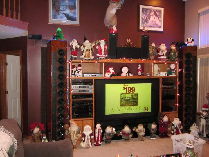

I can't help you with the specs but those look like some very happy North Pole Nomes.
