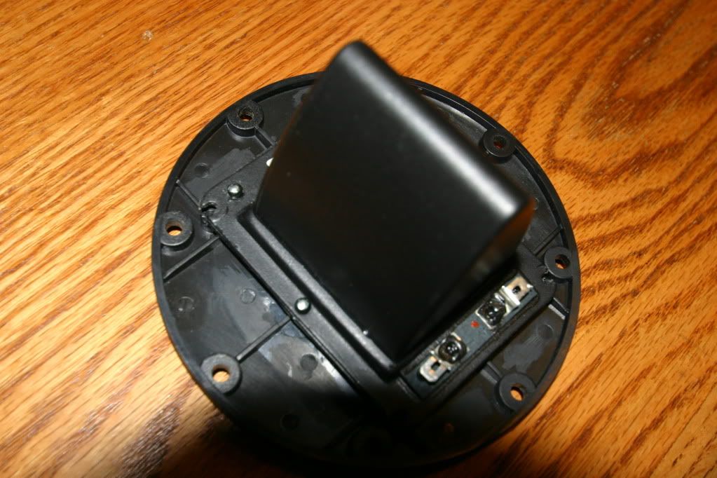

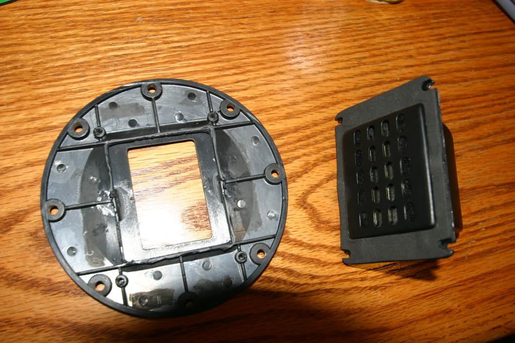

Tweeter has me confused.   Does the baffle gasket get attached to the baffle or directly applied to the cabinet?  The baffle has 8 screw holes and I only have 8 screws, so no screws to attach the tweeter to the baffle.  What size and type screws do I need for these as the wrong type might strip out the plastic screw hole.

here is the screw I am unsure of what size i need.

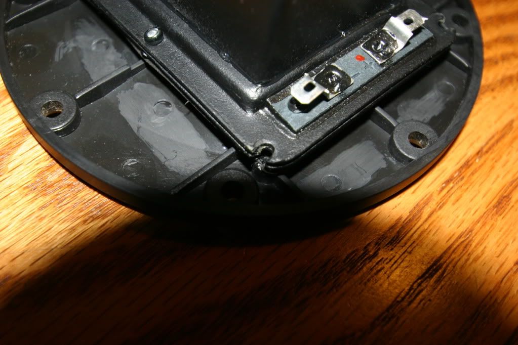

First or all, the gasket that comes on the tweeter can be discarded. It is just supplied for use with custom made face plates and stuff. I use a very small and thin bead of Silicon around the inside edge of the tweeter face plate to seal the tweeter to it. Using the gasket with the face plate sets the tweeter back a bit and makes it hard to mount. Even BG doesn't use it with their face plates.

The short screws for mounting the tweeter to the face plate should be in the same bag as the screws to hold the tweeters to the front baffle. And the bag with those screws in it is in the same bag as the tweeter face plates. Those are all supplied and packaged by BG.

Thanks for the reply Danny... I ended up figure out what I needed and got it all at home depot. The bags for the tweeter faceplates each had 8 screws in them, which is just enough to mount the plate to the enclosure. The ones to mount the tweeter to the faceplate were missing. No biggie, I found the correct size screw and mounted them just fine, only cost me $0.69.  I did use the gasket should I go back and take it off and apply silicone instead?
