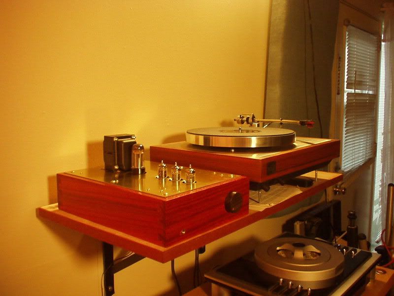

Bill Epstein
Re: The Journey Begins!
« Reply #4 on: 17 Feb 2009, 10:45 pm »
My 3 cents.
A Hammond steel box, 12x8x3 is OK if you use a metal-cutting blade to remove the fold-over at the rear. I have one in black all drilled for the Clarinet but will use the wood chassis I built instead. I built and threw away an aluminum one and I can't imagine the 2" deep boxes working.
Consider that you'll use 3 to 4 board feet of nice hardwood, the top plate will cost about $25 from on-line metals and you'll need 15 or 20 bucks worth of copper/aluminum foil and fasteners. That's about the cost of the Lansing box.
My very first Cornet build was just as pas is thinking, a brass top and back plate on a padauk chassis. No foil lining in those dyas and it hummed just a smidge with very sensitive speaks.

Oh my, those are beautiful.  Bill, I suspect the photo doesn't do justice to the dovetails in the case work.  Now I've got lots more work in front of me!
