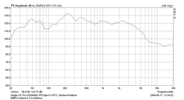

Hi Rudolf and Graham,
Another measurement. I moved around a bit and this is at 3 m distancance and at 90 cm high, about earlevel. I think that your arguments are documented.
It is not the Venetian Blind units, I have to many 12" laying around. I played these together with Monacor 130X/8s with good results. However when you compare these quite cheap units to a very good construction like A&D 1524 (also very cheap) they simply don't match even if you can play lower with the BDRs. I sincerely hope that the Eminence Alpha 15s will prove better. The U is also a bit 'longer' than MJK suggested 26.5 cm vs suggested 20 cm. My only intention was here to prove MJK's case. You can go really low with suitable units. This last measurement also reveals the building up for the main resonance at about 230 Hz, the 50 Hz buildup is room dependent.
/Erling

« Reply #22 on: 17 May 2008, 12:23 pm »
... With the drivers at floor level it would powerfully excite room modes.
With the drivers 4ft above floor level the LF reproduction was firm, clean and much less tiring to listen to.
You could still hear the 'box', which I do not like, but this comparison showed me that whilst bass drivers at floor level can provide Home Theatre 'power', they also become noticeable in a way which detracts from enjoying music due to their increased effect upon the room.
A fine example of exciting the vertical room mode with a monopole.
Also, when sitting on the floor close to this monopole when the drivers were say 2ft above ear level, it was not possible to hear some low frequencies, say below 25Hz, even though you could see the cones shifting air (as David has observed with his Dipole), this being due to the the wavelength and the room, though the handle on the bathroom door at the end of the hall could be vibrating away.
If you are sitting right in a pressure node of a room mode you hardly hear it, regardless how much it is shaking the door in its pressure peak at the room wall. Did you check with moving to another position in the room?
Hi Rudolph,
A response dip around 300Hz (plus a lift around 400Hz) appear when you raise the driver.  Is the software accounting for dimensional effects due to U-frame dimensions, or floor bounce to the listening position ?
Cheers ........... Graham.
Yes, the simulation accounts for all U-frame dimensions and for the floor bounce with regard to a specific listening position. For both curves the listening position is 1 m in front of the baffle and at 80 cm heigth.
So it does not really reflect Erlings measurements, but is simply an exercise in lifting a driver in a U-frame.
