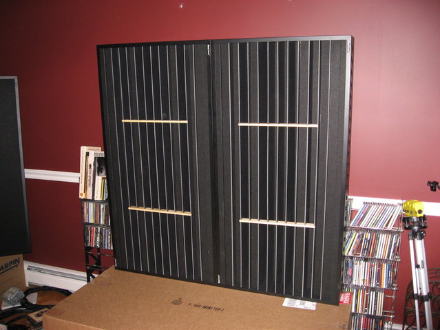

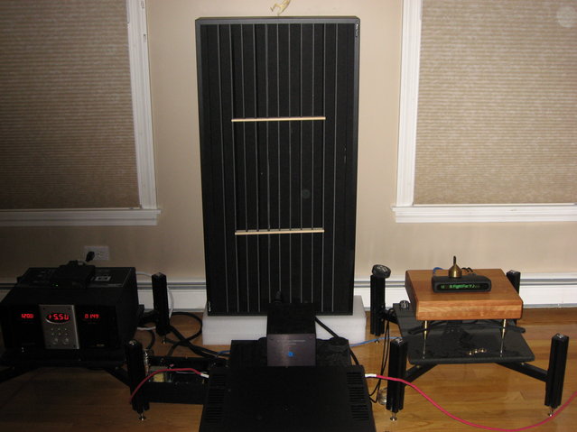

Ok, here a few very rough pictures.  Keep in mind that these aren't fully setup, but rather just plopped down so I could get an idea of their performance.
George
Front of the room with a single diffusor from the listening seat.
Close up of a single diffusor.
Back of the room with two diffusors.
