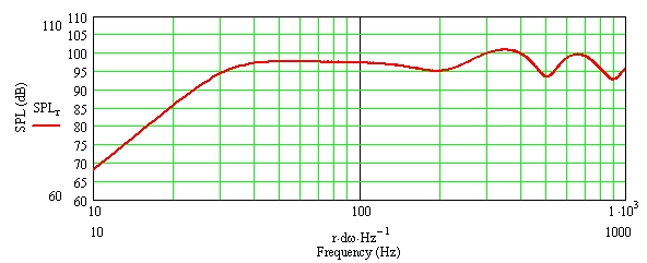

Thanks for your comments, and thanks again for the helpful MathCad worksheets. I've attached a sim of what I'm hoping is my summer project -- Fertin 20EX and Madison Executioner X21 on a baffle 26"x42". If I don't finish working on the back deck first before starting another speaker project, SWMBO will tear me a new one and since painting weather here in NJ is about at an end until next year, it'll be April at the soonest before I get started on the speaker prototype in earnest.
Regards,
John

Very impressive response.  Can you tell us the crossover and boost configuration you used?

High-pass is first-order at 132hz. Low-pass is first-order at 28.5hz with 15db of boost, and out-of-phase. With first-order filters, I'm planning on PLLXO's, a cap for the high-pass and a RC filter for the low-pass. The Madison pro audio woofers are 21" across and have 18mm of xmax & plenty of power handling.  I'm cautiously hopeful the asymmetrical xover works out in practice as well as it models. I have some concerns about amplifier integration, with SET on the top and pro audio on the bottom, but we'll see.
If you'd like, I'd be more than willing to email you my worksheet so you can take a closer look.
