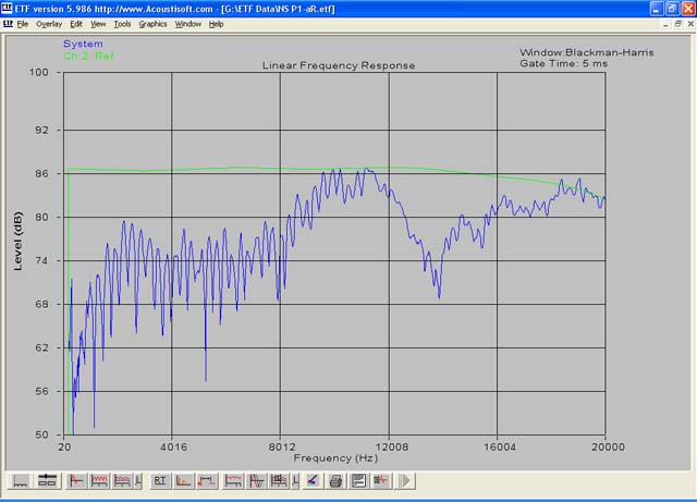

Has anyone compared TACT measurements with ETF measurements?  I think the TACT is performing smoothing relative to the measurements EFT gets.  That's only natural, as the filters in the TACT probably can't invert a wildly varying room response, but it makes the room response look much smoother than it really is.  For comparison, here's a measurement of my RM40s (using a low frequency sweep):
Note the not-too-bad response of one RM40 loading my massive room, measured at my listening point.  I should point out that 60Hz is leaking into this measurement.  So the peak at 60 Hz is not correct.
Another one of the HF response (using MLS, so the low frequency response is suspect):

« Reply #48 on: 11 Feb 2006, 02:38 pm »
I don't see why you couldn't measure the LF response at the "port" and the LF response a bit upward, in front of the woofer.  ETF gives you the phase response and you could determine the difference in phase at various frequencies.
