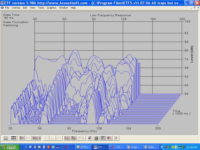

The first problem?  I'm not really off the grid even with a USB sound card and running on battery power for the laptop.  The following is a spectral decay plot of the LF response, without using the PSD function of ETF:
As you can see, there's 60Hz leaking in somewhere, not to mention a ton of other noise.  So, I ran a PSD test:
This is better!  However, there are still quite long decay times, considering I have 2 mondotraps, 2 ASC subtraps, 2 HF minitraps at the first reflection points, 2 microtraps positioned between the speakers, and 2 4-foot soffit/stand traps.  Granted, the LF of the minitraps/microtraps probably isn't that good, but I'd expect better than this.

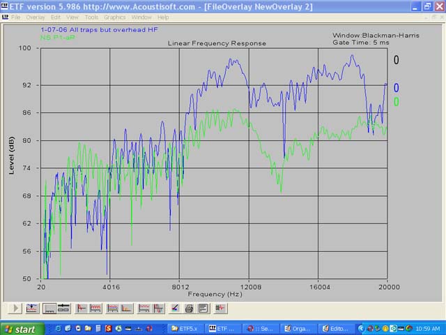

Another problem is the HF response:
The blue curve is both speakers taken today and the green curve is the right speaker taken at "position 1" when I was testing positions of the speakers.  Position 1 is basically the same position as I have now.  The Position 1 curve was taken many moons ago, but I haven't changed anything in the interim (though I did install a midbass upgrade on my RM40s, but this wouldn't affect the high end).  Why the disparity?

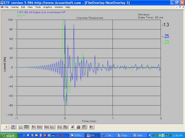

Looking at the impulse response:
Ah, here's a problem.  The blue curve is the current impulse response of the system, and it's bad.  There's a ton of ringing prior to the main peak and a lot of ringing thereafter.  What these translate into are high frequency components (although it's unclear when ETF begins its analysis -- does it cut off the information prior to the first peak?).  The green curve shows the response from the old "Position 1" measurement.  Note a dramatic decrease in ringing both before and after the main peak.

1) What's causing the ringing?  Is there a filter setting on the sound card or some other setting that can cause this?  My HT system is basically the same as before.

I had a similar ringing problem with ETF a couple of years ago and I think (memory is not real strong here) that I had to change the sampling rate of the soundcard. I think it was set to 44.1KHz and I had to change it to 48.KHz. (could have been the other way around) Don't know if this is your problem but worth checking. Note my ringing problem was with the loopback connected to calibrate the card.

> I think you're right about the sound card causing the ringing <
Here's a thought: Depending on the sound card, you probably need to configure its internal mixer correctly. If it's set to echo the inputs back to the outputs, which is sometimes useful for recording, that could cause a feedback loop and ringing. You have to go into the sound card's control panel or mixer to set the inputs to line input only, not to a mix of various inputs and outputs.
