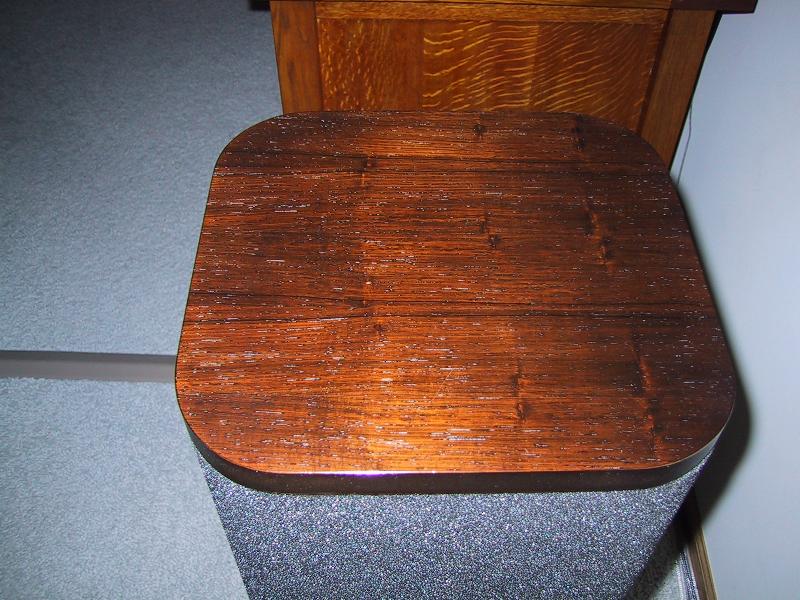

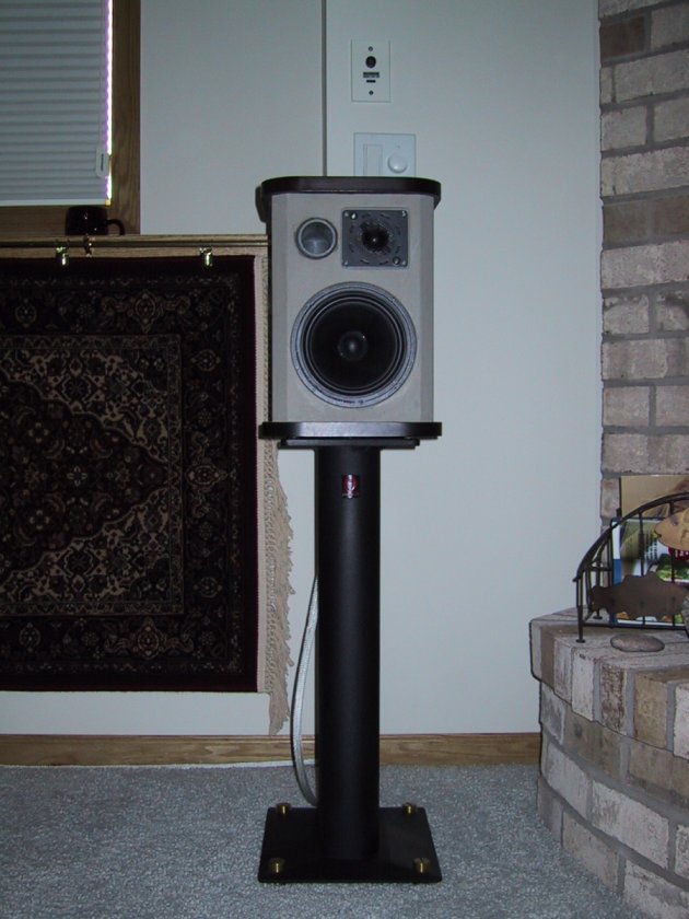

Cut-Throat
  • Posts: 58
Re: Check out these speakers made of concrete.
« Reply #16 on: 24 Dec 2025, 12:30 am »
Click the link: https://youtu.be/sUt55YpTzAw?si=ompJSTfxL8fZzC-9
I had a pair of Rauna Tyr speakers that were made in Sweden in the 1980s...... They were about the size of the Paradox 1s that I owned.  (Yes, they sounded better than the Paradox 1's) I could not find a pair of Monitor Speakers that sounded better, despite trying and throwing $5 Grand at the problem. I gave them away to a good (poor) friend of mine when I got into Large Horn Speakers. They were made of Concrete and Had a Rosewood top veneer. I found them used at a stereo shop for $200 in 2003.
