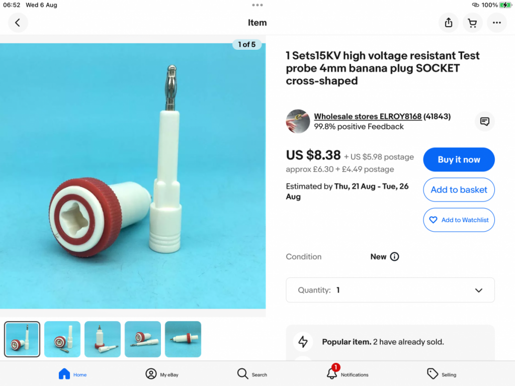

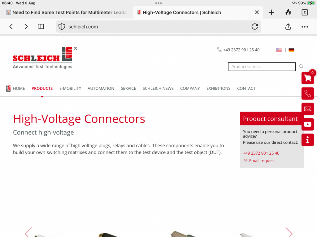

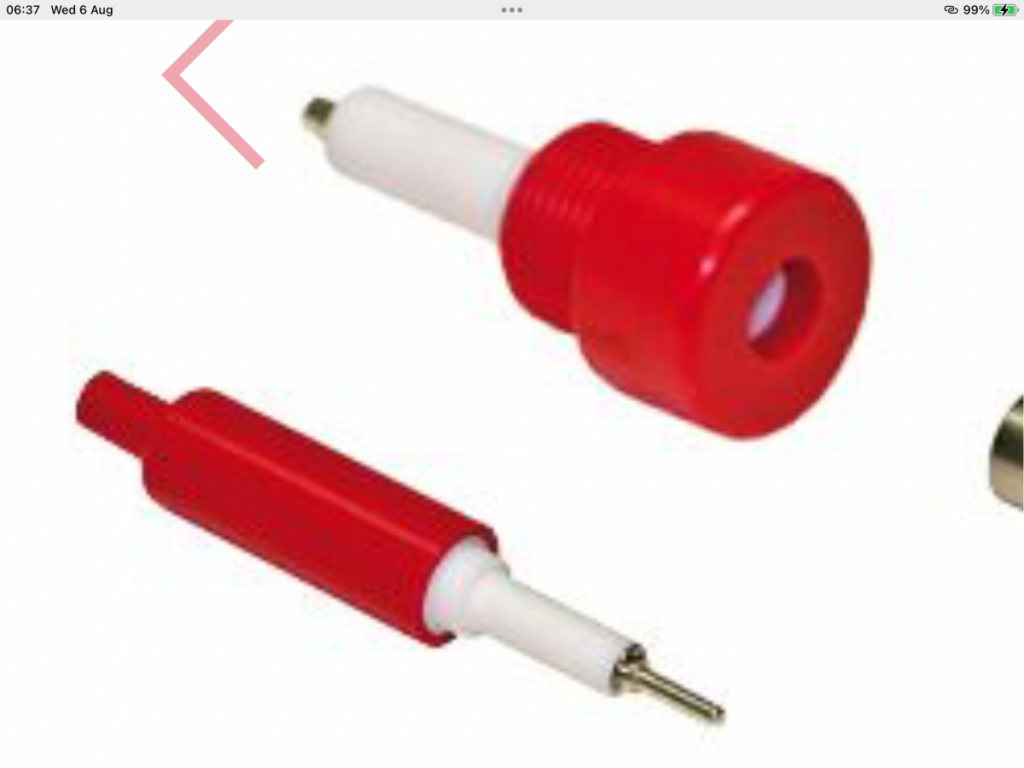

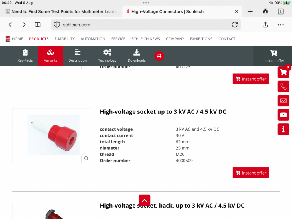

A simple Google search for “High Voltage Test Sockets” came up with this company.
You will, of course, need a high-voltage test-probe.
I assume this is what you are talking about?
Fu Manchu’s descendants will also gleefully sell you something that ‘looks’ similar, for $10 on eBay.
(“Dear valued dead customer. So solly my friend you experience bad troubles with ploduct. Our big apology that it kill you. If please you sending back to people republic Shenszeng, and operative process your refund within 28 day, or never - whichever come first. Have nice day”)
