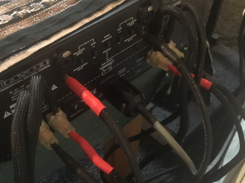

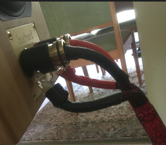

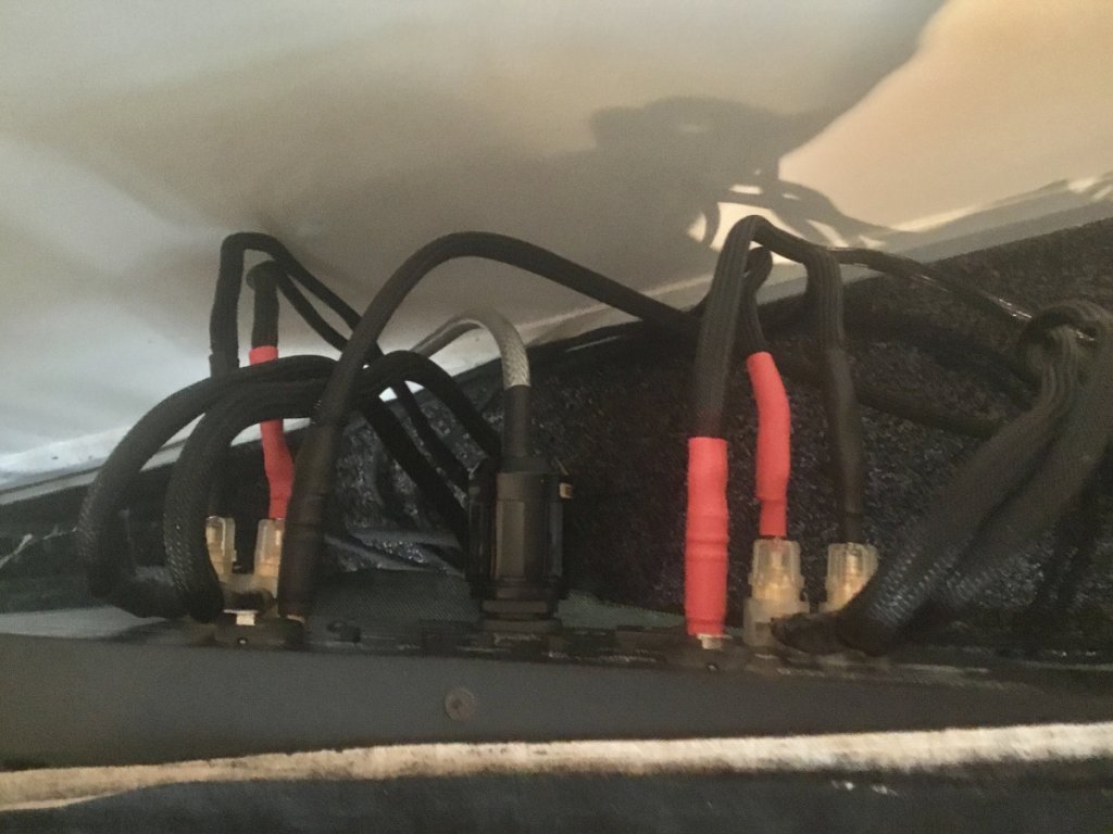

Because of different connectors at each end (spades / bananas) I want to reverse the direction of my speaker cables in order to connect a new pair of speakers. They're high quality (read: expensive) silver cables & its a pain to reverse them, but this would be easier than changing the terminations. Directionality seems to be controversial - does anyone here have any experience of this? I know I should listen for myself, but, as I implied, changing the direction is difficult (because of access - the 12 foot cables go under the floor). Thanks!

Can I be so impetuous to ask why they need to be reversed?  Most speakers have five way binding posts.  Then I thought because it's the GR Circle they might be Speakon at the speaker end, but that doesn't fit my brain either.  Curious minds want to know.

Letitroll98 my situation may be different but I recently had to get the amp end of my cables reterminated from locking 45 degree bananas to straight bananas because the binding posts of my amps were either stacked, leading to awkward orientation, or too close to the bottom of the chassis to clear the shelf.  The same problem exists with a second set of cables with spades.
The speaker binding posts are unusual, by Danish company Argento Audio. They won't accept my right angle WBT bananas because they have (what they call) a "protective sheath" which needs a straight banana plug in order to reach through the sheath & make contact. The cables are cryogenically treated and so I don't want to change the plugs! If I reverse the direction then the spades, which are presently at the amplifier end, will fit the speakers with no problem, and there's plenty of space around the amplifier end to accommodate both the bi-wire spades  + bananas. Its a big job to reverse the cable, but easier than changing the connectors. However, I don't want to compromise the sound!

« Reply #5 on: 4 Aug 2025, 05:21 am »
Fyi VH Audio sell most popular high end connnectors, and offer cryo treatment as an option (see link - https://www.vhaudio.com/cryo.html). But I understand if you don't want to mess with the factory terminations. Re: reversing the cables, as other members noted - as long as the cables aren't directional there is no problem reversing them, and the cables should settle in within a couple of days without getting too techy. It's easy to tell if the cables are directional, as there are usually arrows pointing in the direction the signal is meant to go. But if in doubt, i'd check with the cable manufacturer.
WBT uses a set screw termination that is almost exactly the same from spade to banana, you could buy 4 bananas and replace the spades very easily, it might be easier than pulling the cable since you have the cables installed in the floor/wall.
Many folks will tell you wire is directional. It is, when drawn the grain boundaries form a chevron shape so the wire is indeed directional. I have people who have told me UPOCC wire is directional, but I sent a couple people cables assembled with wire in one direction and another with the wire direction mixed 50/50. Both folks told me the directional cable sounded better, but it was really the 50/50 mix. I honestly can't tell and in this particular case I don't think there's any difference. I am pretty sure most UPOCC wire isn't strongly directional as there is no grain boundaries, but UPOCC starts as a cast billet and is then drawn to size, so it is possible UPOCC wire may be directional depending on exactly how it's made. With conventional wire there's a much stronger argument to be made that the wire will indeed sound different depending on direction. Your cable manufacturer may or may not be aware of any of this, and it may or may not matter depending on how the cable is assembled and it's particular geometry.
