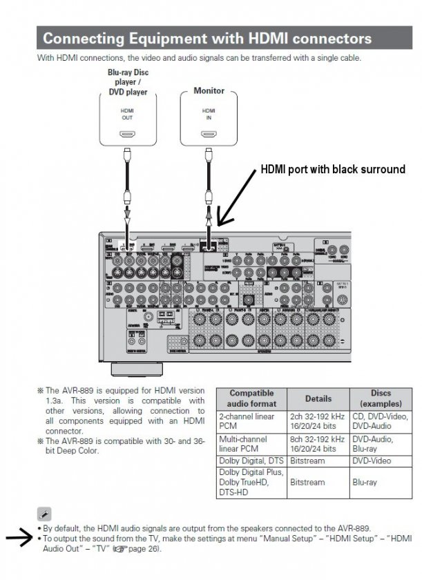

Your question is worded real strange. Why would you need to output audio to the TV? Connect the HDMI audio source to one of the Denon's HDMI inputs, pick that input number on the remote and music will play without the TV on. I listen to music and podcasts from my computer all the time which is connected to my surround processor by a HDMI cable. All audio is processed in the computer, HDMI is carrying some sort of digital analog signal.
If you are playing a ripped music video from a computer then it should work like a DVD, of course the TV has to be connected to the Denon by another HDMI cable.
The Denon can only decode/play MP3 files (MPEG Audio Layer-3) and AAC files (MPEG2-AAC / MPEG4-AAC). Input FLAC, WAVE or DSD and you probably won't get any sound.
Getting Sound Out of a TV
You will need a HDMI cable connected to the Denon's HDMI port that has the black surround. All connections are specified in the manual.
Choose the TV's HDMI IN/OUT port, which is found in the TV manual. Depending on the age of your TV, you may have to enable HDMI ARC or eARC in the TV SETUP onscreen menu. I had to dive into the onscreen menu to enable HDMI ARC in my 12 year old Panasonic plasma TV, which for some strange reason is called VIERA Link. Enabling HDMI ARC was easy after reading the downloaded PDF manual.

The manual for the AVR-889 is readily available for download online. https://www.denon.com/on/demandware.static/-/Library-Sites-denon_northamerica_shared/default/dw900035eb/downloads/archived/avr-889-info-sheet-en.pdf
If you take a look at it, you'll see that the AVR-889 has four HDMI inputs, and one HDMI output.
