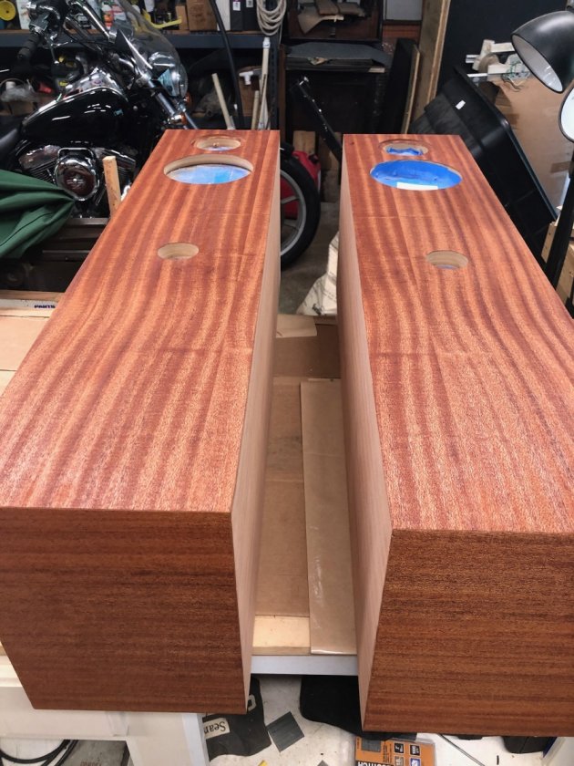

To be fair, it was always going to be veneer whether it was BB or mdf. I'm not so keen on painted finishes for speakers in my home system, but I’ve used many a catalyzed paint finish at work…it really takes the daily abuse touring dishes out.
These are mdf wearing a layer of mahogany:
