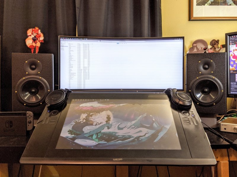

I mean sure, but I have a few reasons against it.. Desk space for one,  since that's going to be their primary position, and I run a 3 monitor setup. Including one that takes up just around half of a desk by itself, and another one behind.
Most any other option, like a separate box will add height, and they're already quite tall..
