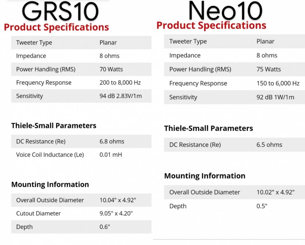

Another odd thing is that the GRS 10" planar shows an 8 ohm impedance in the PE add, but the datasheet shows 4 ohms.  The BG NEO10 is 8 ohms, so that would change the passive XO design, if the datasheet is correct.
Nah they're both 8-Ohm loads according the the PE pages, and the PDF sheets, but there are some other minor differences.
look at the differences in how their sensitivity is measured tho..
BG following the industry standard, and GRS doing whatever i guess.. :lol:

The first GRS 10" planar datasheet I downloaded says 4 ohms, they just changed the datasheet recently to 8 ohms.
Interesting.
Hobbsmeerkat
  • Posts: 2741
Re: Corona Virus update (See latest update).
« Reply #62 on: 18 Sep 2020, 04:14 pm »
That's really weird. Cuz the PDF does say 4ohm but the impedence graph clearly shows a 6.8ohm load??

2.83v is definitely an industry standard.
Hobbsmeerkat
  • Posts: 2741
« Reply #64 on: 18 Sep 2020, 04:49 pm »
I actually had to do a little digging but you are correct. 1W is the same, 2.83v^2/8ohm= 1W its the same measurement, but stated in a different way.

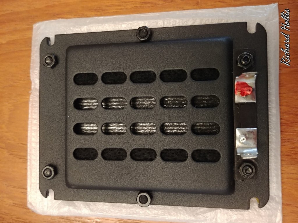

Here are pictures of the new GRS PT2522-4 planar tweeter that came today:
Look very similar to the BG NEO3-PDR style tweeter.  Definitely says made in China on the package.
Should be interesting to compare to the original BG NEO3 and the GR NEO3 in the Super Mini baffles.  I purchased the Super Mini passive XO kit's from Danny today to test with my test baffles that has his GR NEO3's installed.  My original pair of baffles have BG NEO3-PDR tweeters installed.
There is no guarantee that they will work like the original BG's.  This is all for trials.

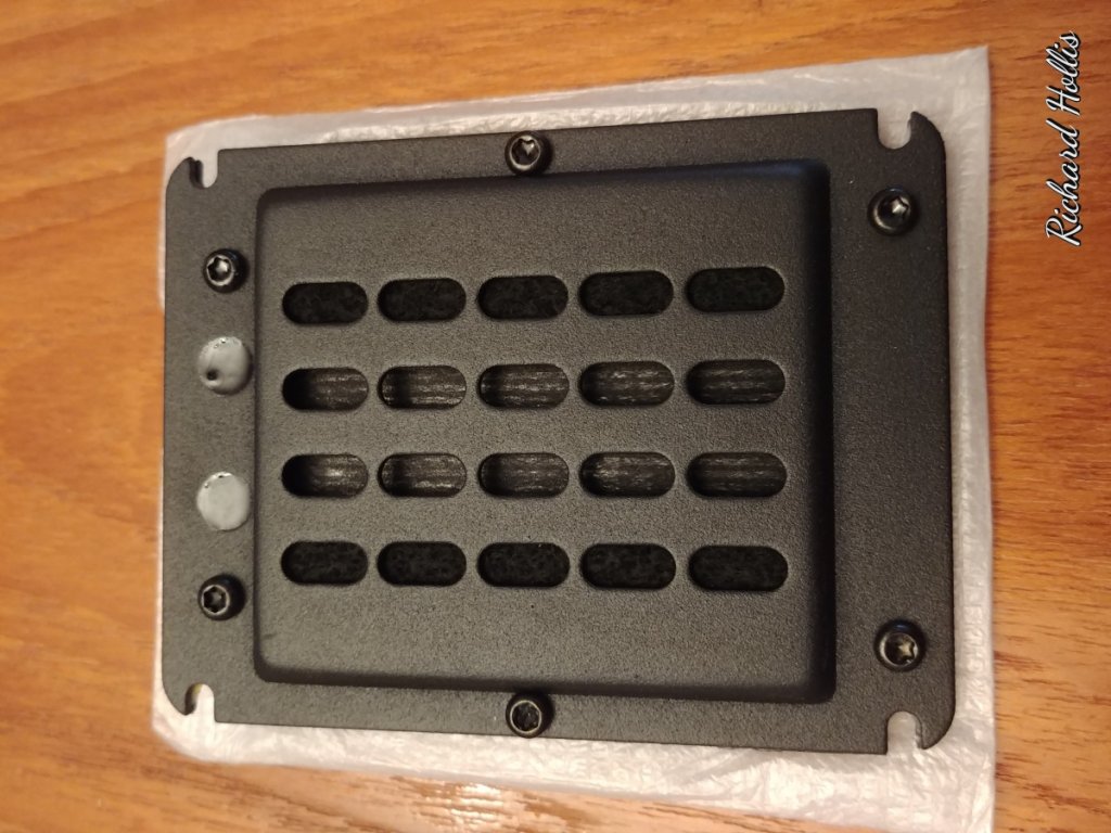

Just got mine as well!
Here's a side by side with my standard Neo 3:
(GRS-3 on left, BG Neo3 on right)
I'm gunna be writing up a thread breaking down the physical differences, shortly.
Feel free to throw in your measurements and thoughts on there as well.

Interesting, is your BG NEO3 a NEO3-PDR version?  Does not look like it has the felt on the planar for damping.
Hobbsmeerkat
  • Posts: 2741
« Reply #76 on: 21 Sep 2020, 11:25 pm »
Here's the thread so we can move the discussion over there:
https://www.audiocircle.com/index.php?topic=172523.new#new
My neo3 is not a PDR, its the standard 10-magnet model, more similar to Danny's current Neo3s.
