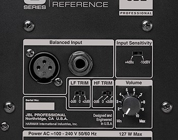

So I want to order some IC's from the pre-amp's RCA into JBL powered monitors. My choice is either the 1/4" TS connector or the XLR. Any preference or sound difference?

Um, though in the instructions, JBL says that with unbalanced connections, one should use TRS.

the instructions says
 " Connect professional equipment with balanced outputs to the XLR or 1/4" TRS input of the speaker using balanced signal cables.
 Connect consumer equipment with unbalanced outputs to the 1/4" TRS input of the speaker using unbalanced signal cables."

Instructions said TRS connector. But there is a TS connector.
Someone messaging says XLR. Others are saying RCA>TS adaptor. But I thought having a connector hardwired would be better than a possible not so tight plug-in.
Just spoke with AudioEnvy and they said I should speak with JBL about if the -10db input is in series with the XLR or the -10db switch itself. (The switch being ideal in my situation.)

Crazy update.
So I spoke to AudioEnvy on Friday, and the guy asked me to contact JBL to find out if, on the audio connections Balanced input, is the -10db switch in series with the XLR input or is it shared with the TS input? So I emailed JBL's technical department that question.
I hadn't heard from them by late Monday pm so lacking info, I went with the safe way and ordered the TS connector since I had already sent in the payment and wasn't sure I'd hear from JBL.
But this morning, someone from JBL responded, "The switch is in line with both inputs and they are both balanced inputs..The switch affects both inputs."
So I immediately called AE and they were just putting my cable together and switched the order to a XLR connector!  :lol:
Thanks for the input!  :thumb:
