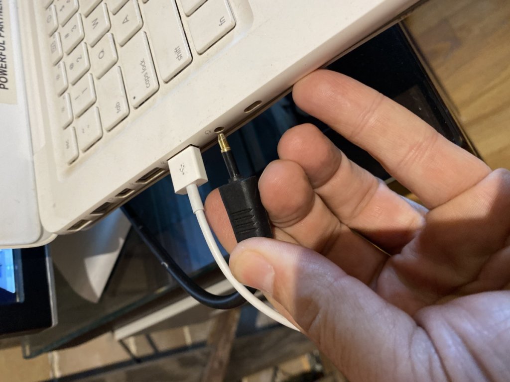

You could see if your model MacBook Pro has an optical digital connection hidden in the headphone jack. I’m using my MacBook this way and I bypass the laptop DAC and send the optical input to my receiver and use the receiver DAC (or you could use external DAC). Check laptop specs for outputs and see if it has optical. You use a Toslink cable with a special mini jack (3.5mm?) adaptor. See pic. You can adjust the output in Applications/Utilities/Audio MIDI Setup.app
Bluish
  • Posts: 7
Re: To DAC or not to DAC
« Reply #2 on: 18 Jan 2020, 05:26 pm »
P.S. I set the optical output using Audio MIDI Setup to 24bit/96 kHz

« Reply #7 on: 19 Jan 2020, 12:43 am »
Excellent information!
I searched for this all day, only to find that the newer MBP's no longer support that option.  Not sure what they are thinking over there at Apple... LOL! (I miss Steve Jobs!)

The new macbook pro do not have an option to stream via toslink link I learned that when I purchased a 13 " this year for my college going  kid He  decided to use my old  2011  MBP and I got stuck with  the new MBP , I do have a Chord Mojo-DAC/Hp/pre/  but that option would cost you another 350 used to 550new  you can try connecting it via USB-C Digital Multiport adapter $ 69.99 from Apple  and see if that would do the trick   :popcorn:
