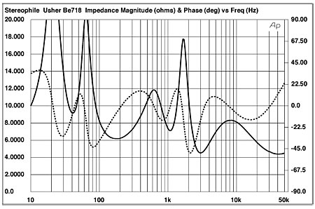

https://www.stereophile.com/content/usher-audio-technology-be-718-loudspeaker-measurements
The Usher Be-718 was both less sensitive than average and less sensitive than specified, at an estimated 85dB(B)/2.83V/m.
Offsetting the speaker's need for voltage, however, is an impedance modulus that remains above 6 ohms throughout the bass and midrange, and drops below 6 ohms only briefly in the treble (fig.1). Only a combination of 5.7 ohms magnitude and –41° electrical phase angle at 2.5kHz keeps the Usher from being rated an easy load for the partnering amplifier to drive.
