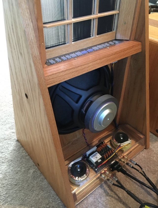

Hi all,
Having sworn off speaker building forever, after the 4-pair speaker project last year; the psychosis is back and I'm now making sawdust on two pairs of my Jazzman MkIII hybrid electrostatic speaker, and both pairs will be for sale.
The MkIII is a symmetrically segmented wire-stator design which bends the wave front electronically to emulate a line source projecting a cylindrical wave front, giving wider and smoother trending dispersion than a curved ESL, or even most conventional speakers.
The frame and stator lattices are solid red oak with interlocking joinery (no MDF or veneers) and will include front & back magnetically attached grills/dust covers.  The bass section uses a 12” Peerless SLS woofer in a tapered H-baffle, crossing over at 250Hz.
The MkIII is not a plug & play design-- it must be bi-amplified using an outboard digital crossover (not included).  I recommend a DBX Driverack PA2 or Venu 360.
These speakers are horrifically labor intensive to build, and after auditioning them at this year’s CarverFest, I've had quite a few purchase requests, so I've deiced to build a couple of pairs to sell.  It will take me several months to complete the speakers and I will post a sales notice probably in the spring.
Just to give an idea of how good these speakers are; one of the guys who bought a pair this year sold his Legacy Whispers and kept the MkIII's.  And he told me that the Whispers had more bass (two 15" woofers, duh...), but the MKIII's are better in every other respect.
Below are photos and a video showing the Jazzman MkIII speaker:

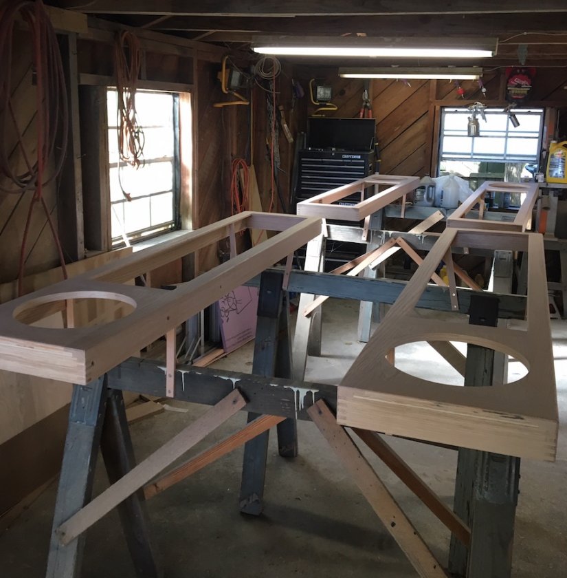

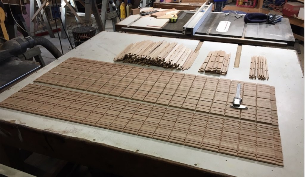

Update 12/6/20:
Speaker frames are completed, ready for stain & satin poly finish.
And this morning I finished cutting the stator lattice details.
In the photo below are 204 precision cut, interlocking stator details for the two pairs of speakers.  I don't have any fancy CNC machines-- everything was cut on a table saw and it's a shitload of work:

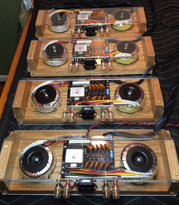

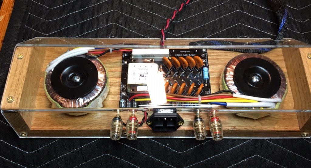

Update 12/27/2020:
All woodwork is complete except for the grill frames.
Today I completed the amp/speaker interfaces, each of which consists of a high-voltage bias supply and a tandem pair of step-up transformers:

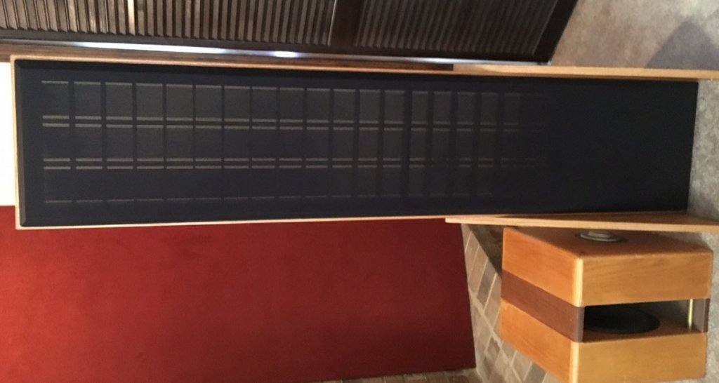

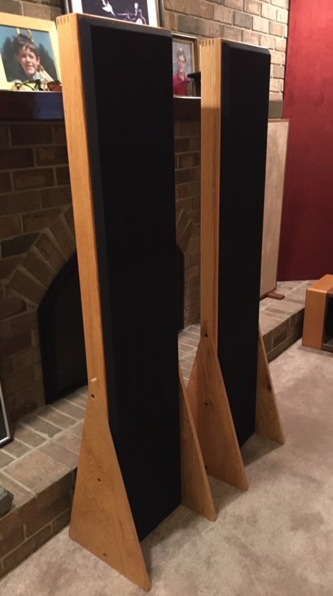

Update Feb. 15, 2021:
Today I received the back ordered woofers to complete the second pair.  As of this evening; both pairs are finally finished.
I've had one pair playing for two weeks, and this evening I'm playing the second pair.   I will burn them in for a while-- to make sure there are no cold solder joints or rattles, and to stabilize the diaphragm tensions.
At some point I will pull the trigger and announce them for sale (sometime in March, probably).
Shown below is the second pair with the grills on.
