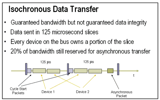

Isochronous mode is used for media streaming because it guarantees bandwidth on the USB bus by scheduling one transfer per available frame. By comparison Bulk or Burst transfers make use of ‘leftover’ bandwidth and may be ‘choked off’ if higher priority isochronous data transfers saturate the USB Bus.
Isochronous transfer mode uses error-checking but includes no re-transmission in case of Cyclic Redundancy Check (CRC) errors. Electrical noise on USB signals causes CRC errors and thus data loss, as does poor signal integrity. In mild cases, this leads to audio signal distortions. In the worst cases, clicks and dropouts. It means that a USB audio device can work correctly only if USB signal quality is excellent and no CRC errors occur.
Note: Do not confuse ‘asynchronous USB’ with ‘Isochronous,’ an asynchronous USB system still uses Isochronous mode to transfer audio.

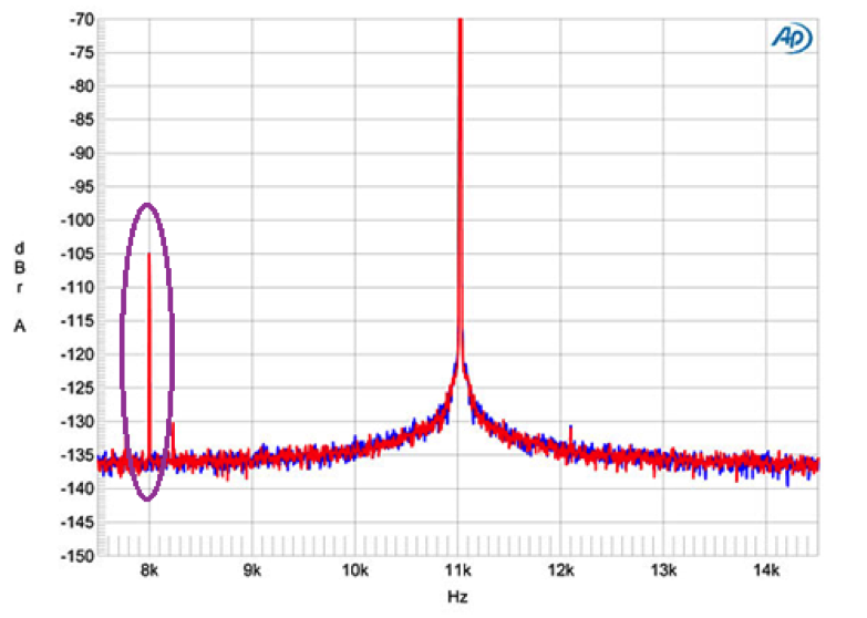

Frame noise
As stated, USB uses 1ms and 125uS signal frames, hence the creation of 1kHz and 8kHz frame noise. Below is a Stereophile test result of quite popular USB DAC from a reputable manufacturer, which clearly shows the 8kHz frame noise.
