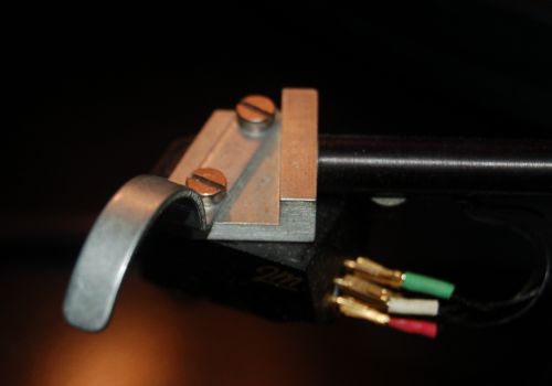

I found this picture while looking at used gear. It may be of assistance to someone. :scratch:

The image in the manual of the WT Classic tonearm matches Steve Ford's picture.  The picture that GB posted does not look correct per the manual.

Just another data point, I came across these pics that show the somewhat awkward mounting of the cartridge off to the side.
https://www.audiogon.com/listings/turntables-well-tempered-classic-very-nice-with-new-cart-2016-03-15-analog-96161-truckee-ca
Strange how some are mounted this way, and others are centered on the headshell in the more traditional way.  I can only guess that the arm changed over time.    :dunno:
   That is how cartridges were mounted on the square motor WTT I used to own. Never used a BPS, only a BP with aluminum adapter. And a couple other HOMC cartridges. Ran a Purpleheart on it for a while.
  The arm looked flimsy. Worked great.

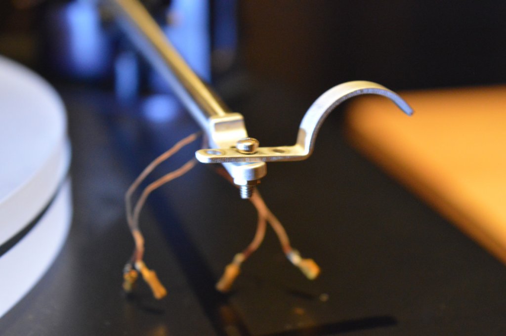

It would be a fortunate coincidence if the mounting slot in the tone arm is long enough & of the correct geometry to mount the center hole on the cartridge while the back two holes on the cartridge are connected to the finger lift. In which case I suggest placing the finger above the tonearm (as per his images) clamping the cart to the tonearm. Just a thought. Hope it works.
Hansdejong image appears to be of an early well tempered tonearm. I imagine his well tempered turntable has a square motor, maybe even a plastic shroud on part of the power chord.
http://www.audiocircle.com/image.php?id=135195
I believe the image posted by SteveFord is a later model WT.
http://www.audiocircle.com/image.php?id=135694
